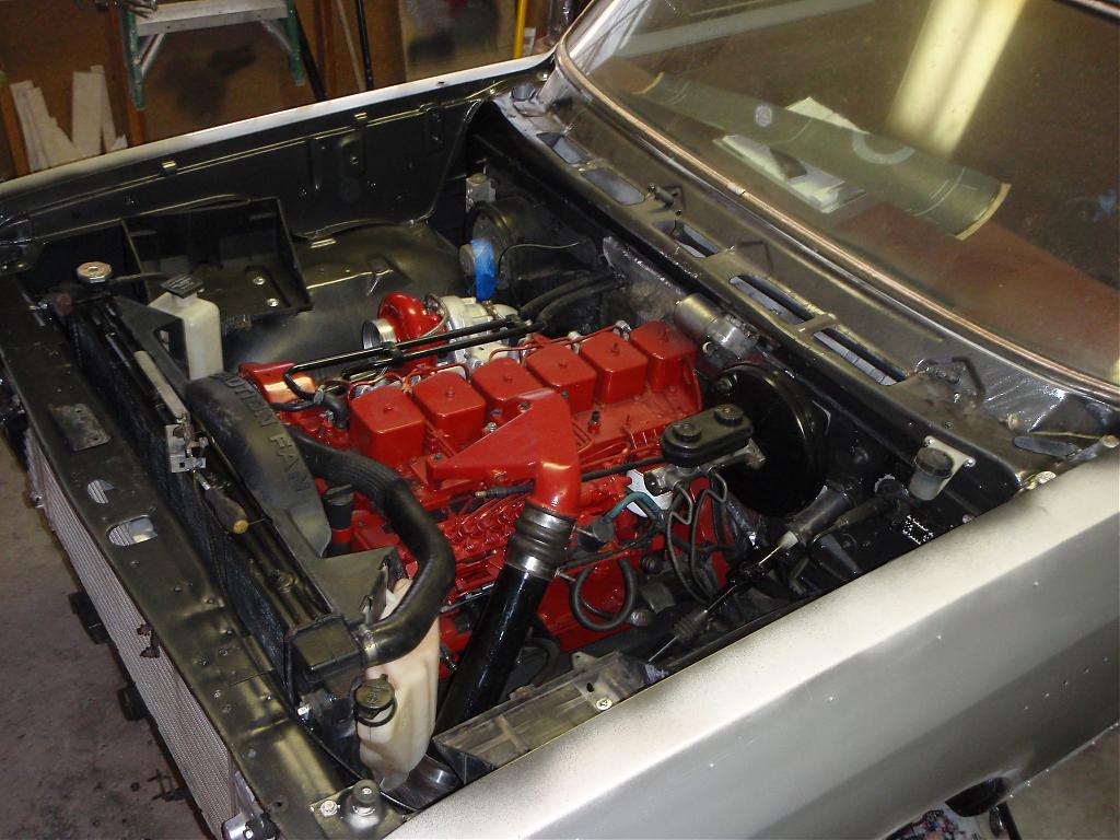

Diesel Ramcharger project kicks off
I don't want to know what a 1450 CV costs. But if you are in Utah or close by and need a shaft Gaylon Pugh in Lehi gave me a great deal on a whole new rear shaft. I was very pleased, especially with the price. I got pretty lucky with Tom's and Gaylon's both are great, but Gaylon wanted to beat up Tom Wood's on the price so I drove the extra 30 minutes and let him!!!
Cut the stock 96 rear blocks down and at an angle to improve the pinion angle. Worked wonders. I still need to make some ladder bars and put new shocks on but those are luxuries. My wife has been tremendously patient as I have been underemployed and (don't tell her) but I spend more money than she does. She is one wonderful Proverbs 31 wife!!! Good news is I have another project (that pays) and should be hearing from the local Air Force Base and will continue on with my MBA as part of their Student Program. (Any GMAT Tips?)
Driving it around and now just working out some small bugs. Exhaust is done and this morning I got the Cruise Control to work. I ended up using the Ramcharger Gauges, the oil pressure is a bit funky, water doesn't work (assuming it doesn't read cold enough?), amp doesn't work as it only reads to 60, but the speedo works and is actually dead on!!! I put the cable sender in the back of my NP241 and with the 3.54's and 33" tires it reads within 1 mph so I am happy. Made a custom pod for the dash for the boost, egt and tach. Still need the sender kit for the tach and I have a new thermocouple on order as mine went south, but the boost works as do the lights. Clutch is holding better so I think it just needed some break in time. Still have some slight vibrations but it may be tires or front shaft, nothing alarming.
Modified the stock pitman arm to give me a better drag link angle which took away quite a bit of bump steer. Its fun and fast, just moves out of its way in a hurry!!!
Still haven't had a diesel head stop ask "what the heck?" but I am sure it will come. Now to get some paint done on it, but I am happy with the interior and getting happier each time I drive it.
Thanks for all the help,

Thanks Michael,
I assumed as much about the tach, but thank you for your input. Now I just need to send back the harness I don't need and buy the magnet kit.
Its a fun project, much more work than I was expecting but thats because the donor was a 2nd gen. A 1st gen would be much easier and cheaper, but it wouldn't have the P7100 bigger radiator and intercooler as this one does.
Have to put new shoes on the rear brakes to pass safety (old ones had heat cracks and a piece missing) along with find a passenger side washer nozzle. Other than that it passed so I see that as a good thing.
I have a book coming for the GMAT, I am pressed for time so I have 20 days. YIKES!!! But I am currently underemployed so I have the time to study.
Thanks again,
Thanks again,
