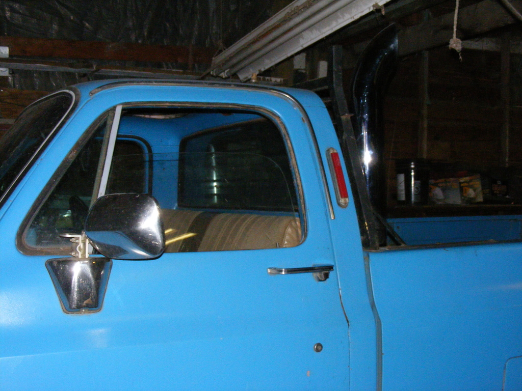

I got my Stacks on
Yesterday i finished put the stacks on my truck. i think they look good they sound awesome. there 5" stacks that are being feed by 4".
Attached Thumbnails '74 chevy Cummins powered-036.jpg   '74 chevy Cummins powered-033.jpg   '74 chevy Cummins powered-035.jpg
Old Sep 1, 2008 | 06:29 AM
BRUISER's Avatar
Posts: 1,237
From: Raleigh, NC
nice job.. they look good
Old Sep 1, 2008 | 07:44 AM
madhat's Avatar
Administrator/Jarhead
Posts: 14,989
Likes: 25
From: Jonesborough, TN
Looks really good... a cummins in a chevy... my dreams...
