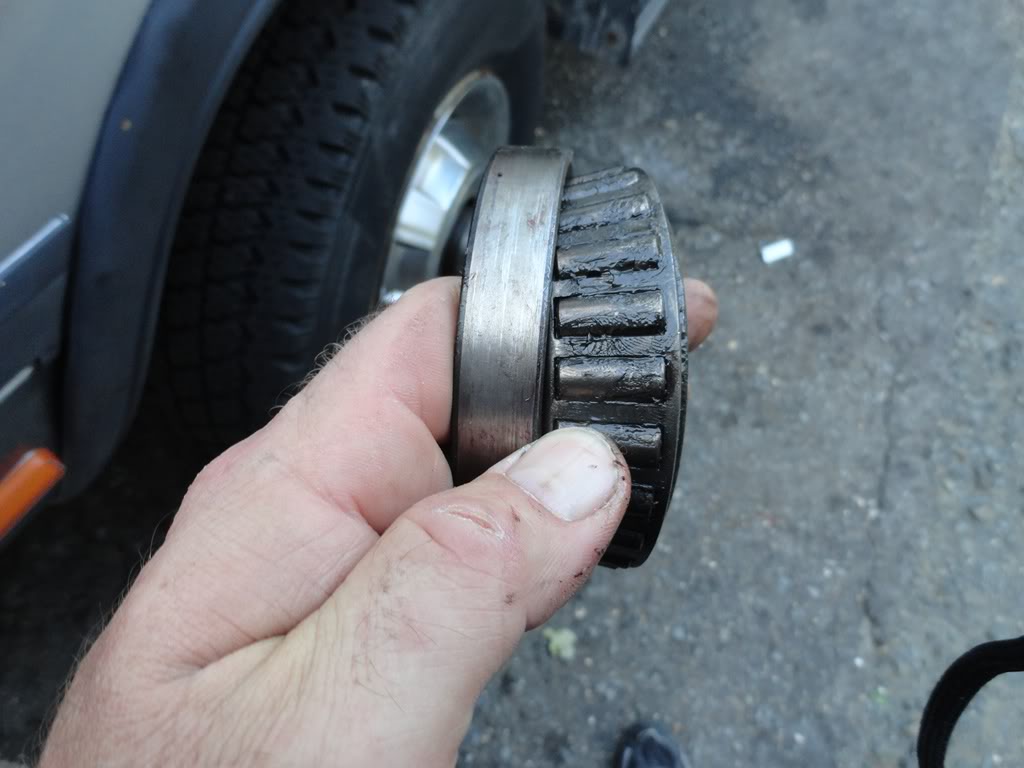

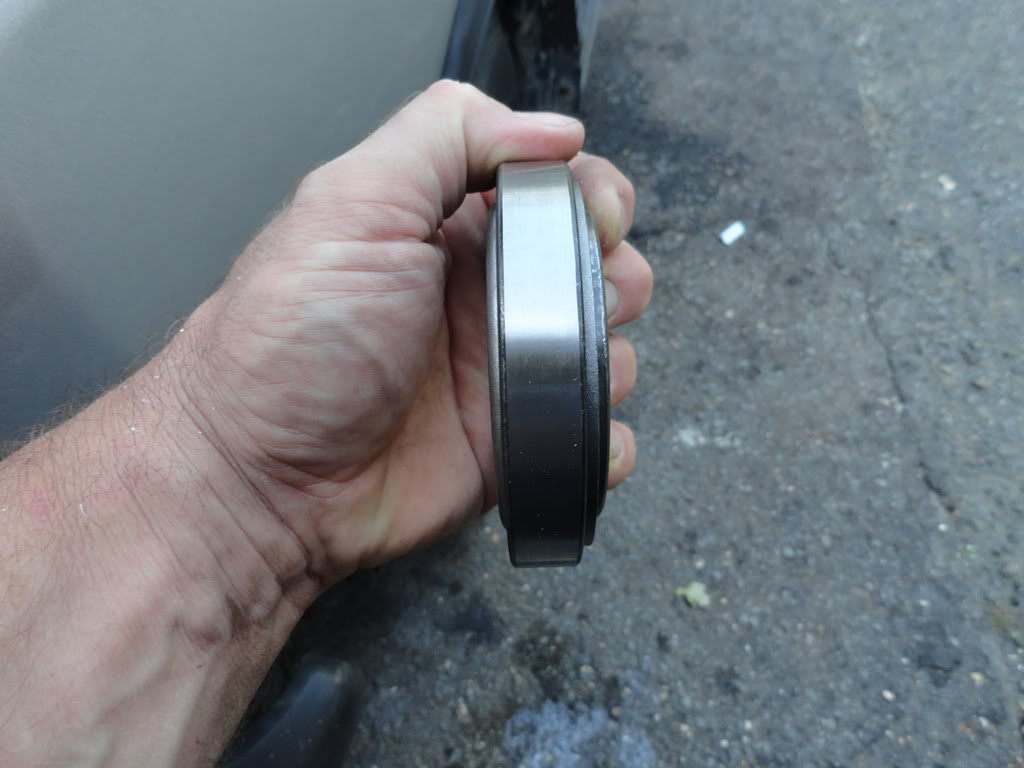

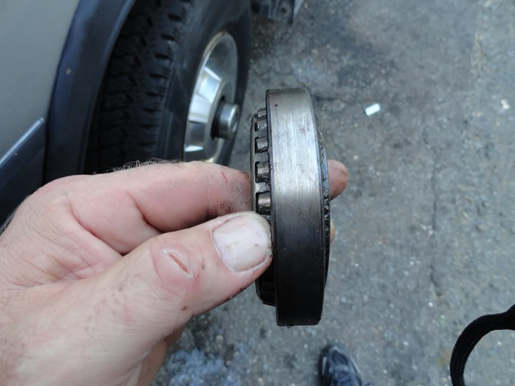

Well, as I began the reassembly, for some odd reason, I decided to "test fit" the dry bearings prior to assembly. Really glad I did, as I discovered that the inner bearings were not matched and most likely the cause of the failure, as they appeared to be greased properly when originally removed.
The original bearings that were in the truck were mismatched on the inner, as you can see in these pix. The brg sat too deep in the cone.

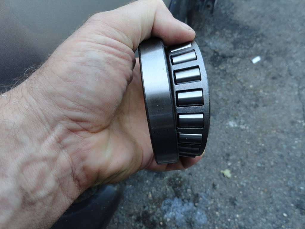

The new bearing and cone (from the actual listing i their computer) fit together correctly.
