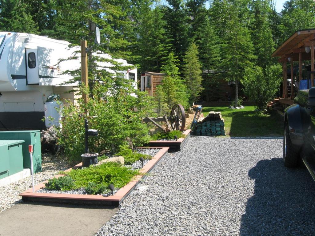

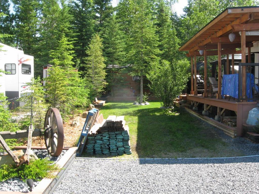

Dad/sister bought the insulation kit as well, R-20(check out Futuresteel website for pics)but we ran out of time to install.Another option is spray foam.There are other manufactures as well from Toro,Powerbilt,Crown steel.Futuresteel was the best price cause they bought 2 buildings together.I am looking at putting one up at at my RV lot in Gull Lake(GABLE STYLE) but i am limited to only 13x30x(12ft height limit) due to my trees/lot size.I want a true 10 foot roll up door to fit my future boat as well as another 10 foot roll up door located at the back so i have a walk though garage to access the back of my lot with my quads etc.I have to make it fit in next to the deck,under the patio cover in the pics.
