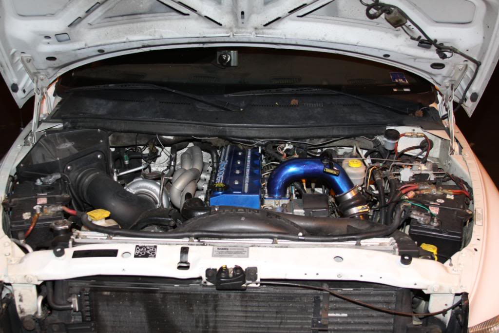

So that's a water cooled Garret on top. It must have a wastegate but it doesn't look connected in the pictures or is it just hidden?

Its a GT4202R (75mm/102mm comp) with a Tial 1.0 A/R stainless v-band housing, feeding a GT3782R (60mm/82mm comp) with a .89 A/R housing. The secondary has the stock garrett wastegate, and it is connected. First run on Thursday, it was probably cracking open around 50 psi, now it starts cracking around 20. I had two Tial wastegates to go into this set, but had no way of actually installing them, since it was stainless flanges and at the time had no one to weld them.

Just wanted to update everyone on our newest twin member and "I can't believe I drove a single turbo for sooo long and twins actually work"
The twins sure fit in nice and Tate did a decent twins build-up.
Nice color choice

holy extreme manifold batman
