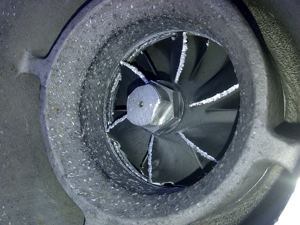

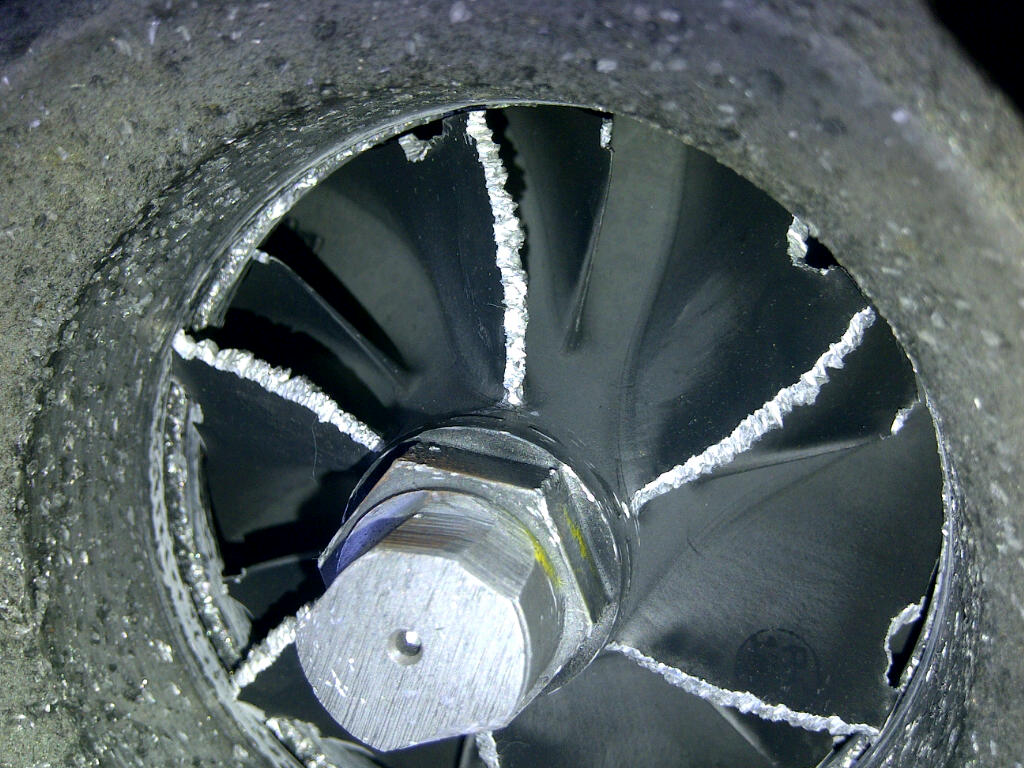

I have a slightly used Garrett with a shade of wear on it from a 60 series. Cheap and in great shape...............
Attached Thumbnails picked up a bht3b..........dont think it will work-img-20110816-00094.jpg   picked up a bht3b..........dont think it will work-img-20110816-00093.jpg

Ok - I am no turbo guru like the ASW guys but in those photos that looks a little FUBAR to me
Jamie, you scared the crap out of me posting that. First thing I saw was a chewed up turbo, then your avatar, then finally the words, had a micro second of heart attack...
Bahahaahaaaaaaaaaaaaaaaaa!!! We had a rig with no power. Took the turbo off and that's what we found. Pretty ugly hey!! The 2 turbo's I have are pretty nice still!
