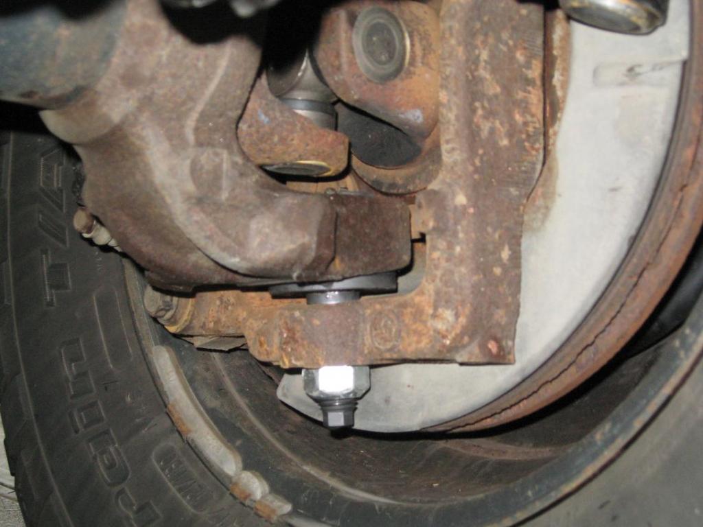

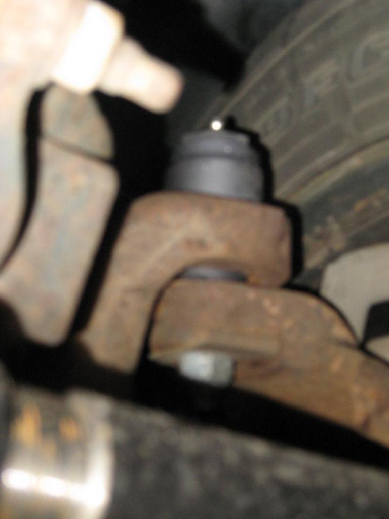

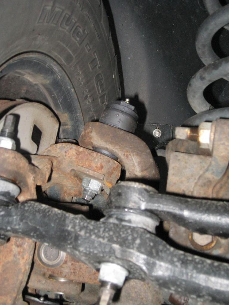

Here some pics of the new front end-----
Attached Thumbnails Front End-img_8825.jpg   Front End-img_8826.jpg   Front End-img_8827.jpg   Front End-img_8828.jpg   Front End-img_8829.jpg

Sure is tight now,tracks straight,more responsive.The 08 steering is a must on the 3 genners as side by side of the parts the old OEM's look pretty small, almost like it was meant for a 1/2 ton.Carli balljoint are a work of art----(KUDOS TO THEM )Hopefully i wont't have to worry for a while while my bank account recovers---but i am putting my Buckstop bumpers on hold for a year until i finish the suspension(Glacier ladder bars,Carli Vari-rate front springs/Bilsteins 5100/trac bar/contol arms/end links are next on the list of must haves)---may also update to a Carli steering damper later on as the 08 steering upgrade came with a new OEM complete----CHEERS DW.PS if anyone is looking for these Carli Ball Joints----NADP in Edmonton is the only place in Canada that had any sitting on the shelve,all other had a month wait----"THANKYOU TO BARRY AT NADP" for getting these to me in one day when my options were looking slim.DPS tech says they are a tight mother to get them installed.

I'd turn that left hand side tie rod so that its sitting straight up and down. Theres been a few guys in the 3rd gen forum with the tie rods wearing prematurely and even snapping because of the angle/binding at full turn. The new steering setup is nice though hey? I did mine plus dynatrac balljoints and its a night and day difference!
Old Jul 14, 2011 | 08:07 PM
DWeiler's Avatar
Joined: Apr 2005
Posts: 757
From: Calgary/Alta
will do.-------DW
