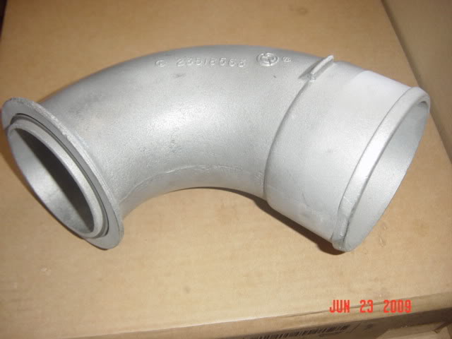

hey what kind of compressor discharge is on that thing?
I have a nice new discharge 90 off an industrial Series 60.
If you can use it.............uses a vband with the oring and double clamp the boot side. Gt42 if thats what you're running is one of the turbos you found on an older series 60. might work for you?
