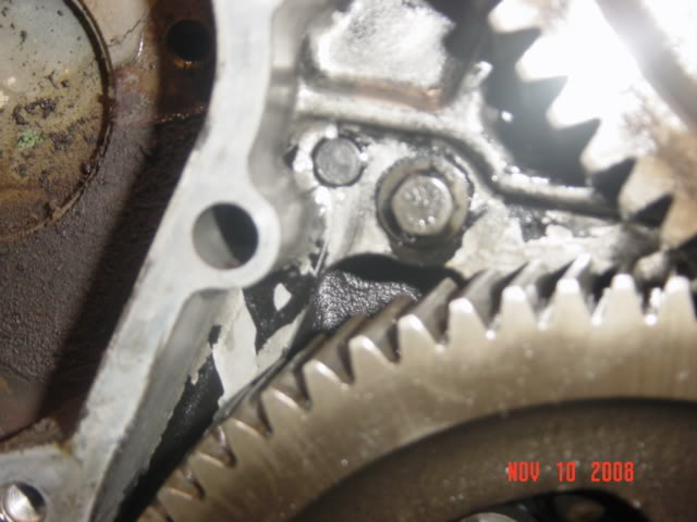

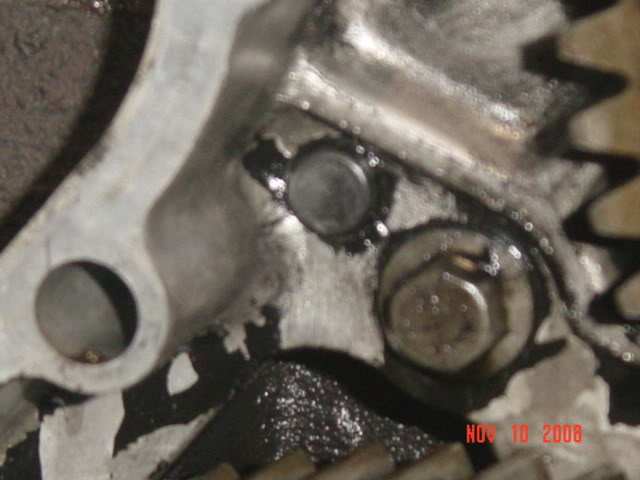

I can tell you some of the damage... as to why... that is a guess without stripping the engine down totally...
I lost the cam (broken), the timing gears spun, some damaged. I assume the key holding the timing gear to the crank sheared (not sure why). This knocked the timing all out, and caused the damage. I am doing the ***-U-ME thing and guessing there are damaged valves in the head, and piston may/may not have been damaged but my assumption is some have. I have decided I don't really have the time to spend on it right now, and with it being a 15 year old truck, probably not worth it to farm out the work. Tranny, axles, transfer case etc. are all good, I think. I'll probably wind up either parting it out, or selling it as is to somebody. On the other hand, if I ever wind up with time, I'll fix it and give it to Dad as a tow vehicle for his new salmon boat. Seeing as he won't finish building it for a couple of years, I have a little time...
Old Jan 16, 2010 | 11:31 PM
1-5-3-6-2-4's Avatar
Posts: 3,142
From: Okotoks AB
Oh.......you got bit by the killer dowl pin.....sounds like.
there is no keyway on the pump shaft. it is strictly a taper seat. if that spun. injection timing would be out and the engine would quit running.
the KDP is directly above the cam gear.
this is the monkey

Nope. First thing checked when it got towed to the mechanics to see if it was a relatively minor issue. Dowel was still in place...
