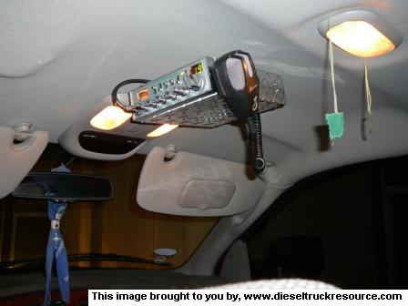

Try this on for size. power came from the batts via routing wires above head liner. This takes time to run all the wire but it looks clean.
