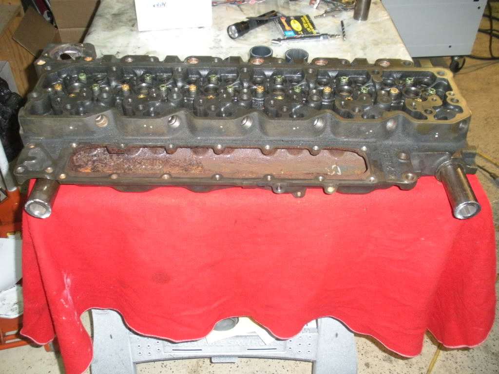

Like I said on ABDiesels, once you've bought an aftermarket air horn, intake plate & spool-aid kit, you've still got the crappy Cummins intake manifold.
This is a CR head with the stock integrated intake manifold. The 2 pipes on each end are driven into 2 removed core plugs.
Air from the intercooler pipe is "Y"'d into these 2 pipes to feed 1 intake valve on cylinder #1 & 1 intake valve on cylinder #6.
This is a huge thread on CF. It took me a while to figure out the very strange way the Cummins head "siameses" the intake valves from separate cylinders.
Very weird why Cummins did it this way.
http://www.cumminsforum.com/forum/3r...review-16.html

Joe, unless you rework the air flow on the inlet air horn, it’s going to difficult to get air flowing into the #1 and #6 cylinders. You're going to need air baffles, just so you can get the air supply directed evenly. Is that a spare head???
I would weld those tubes in at least. Never known epoxy lasting very long in a hot, oily environment. Could also throw on a 6.7L air inlet, air horn, more inlet volume. On a 6.7L air horn mod, you also need a 6.7L rail, and injector tubing for this mod to work. Even better if you could also get the 6.7L CP3
The S475 or S480 is another good turbo choice for a primary. A decent sized twins external gate at least 40-50mm size.
