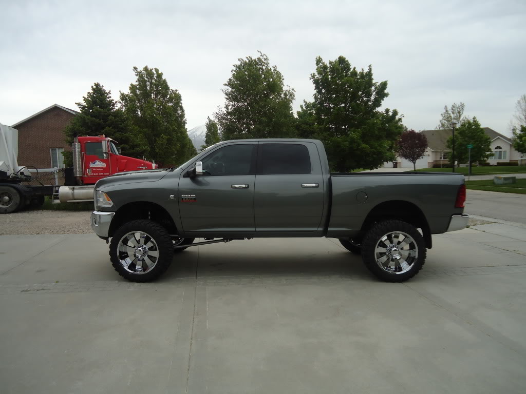

Old Apr 1, 2012 | 07:04 PM
jr22's Avatar
Posts: 187
From: Northwoods of Idaho
work in progress
