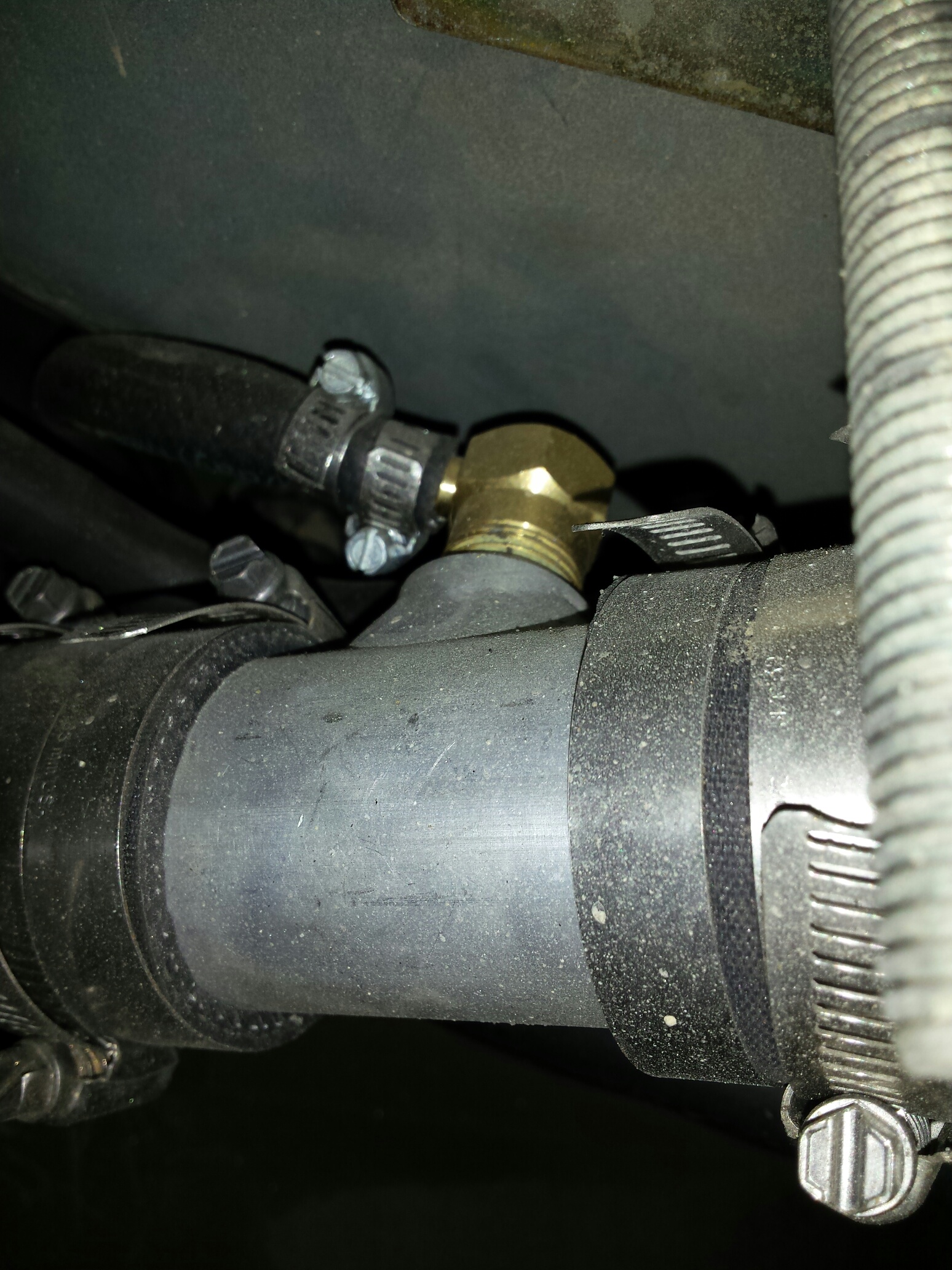

I am about to install an auxiliary fuel tank in my 14 MegaCab.
Can anyone provide a photo of the T connector installed.
I am interested in the location you put the T along the fuel fill line to the main tank.
How much space is there to work with etc.
I plan to do this as soon as all of this snow is gone!
Thanks
Doc

Can you weld?
I just welded a 1/2 NPT thread-o-let onto the filler and threaded the float/ball piece into it.

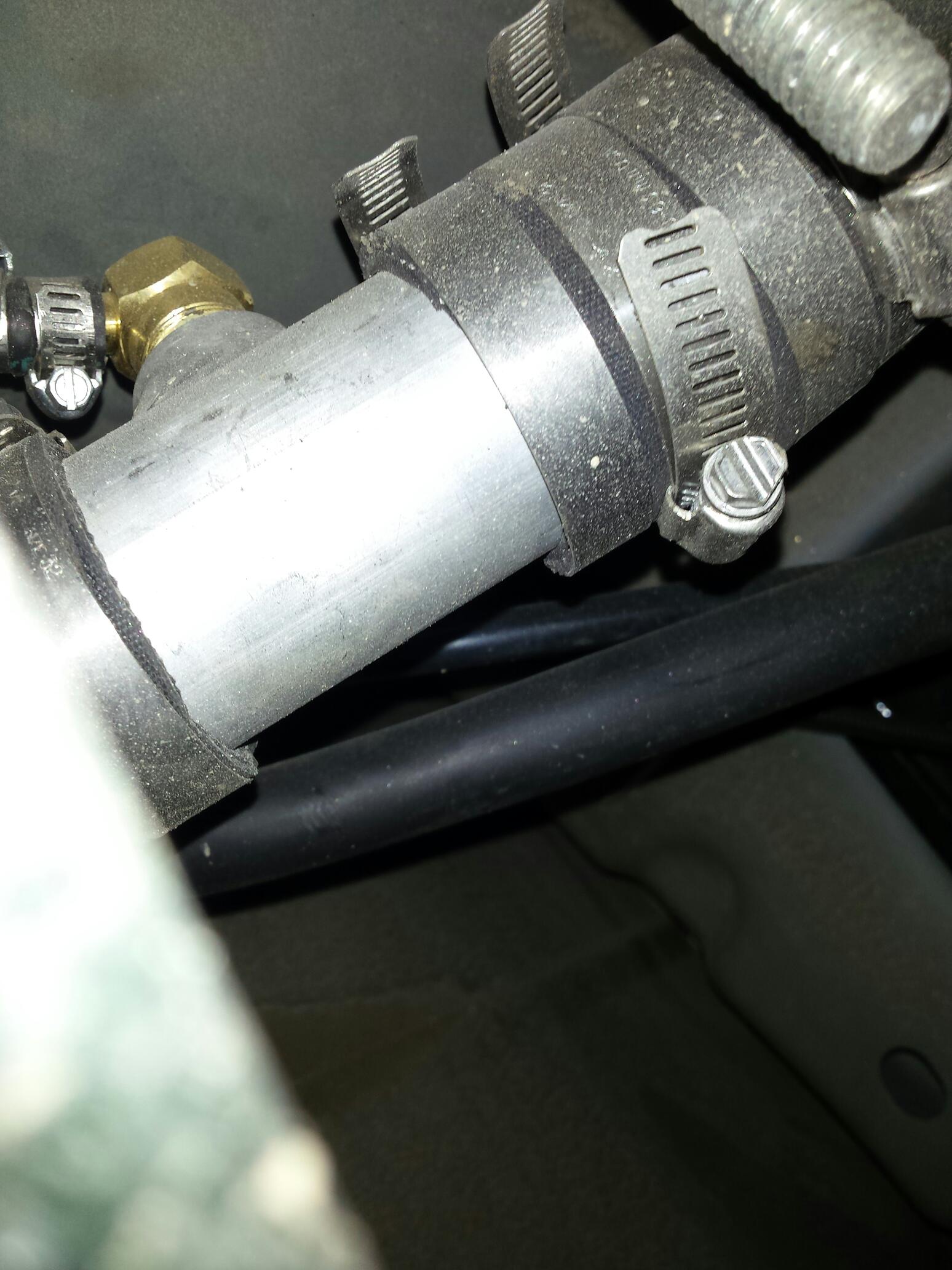

Funny I just posted this
Attached Thumbnails Install T inlet for Aux fuel tank in 14 SRW-20160305_125905-%5B533386%5D.jpeg   Install T inlet for Aux fuel tank in 14 SRW-20160305_130111-%5B533385%5D.jpeg
