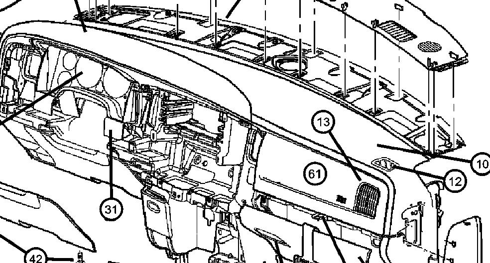

Where to buy instrument panel?
Where to buy instrument panel? Part number 10.
What is the price about?
How about change is it big job?
Mine is broken=Texas sun?

Genos has a nice replacement. Genosgarage.com I think. It is either that or get the part number from the dealer and do some online shopping for dodge parts. Do a google search. There are several online oem parts suppliers. It helps if you already have the number though.

Part #'s for the upper dashes are WL86WL8 AA for taupe, and WL86XDV AA for the dark slate. Finland? For real? Chrysler is having a BIG vendor issue right now with these and they are on backorder. Unless you find a dealer with one, and who will sell it, you will be out of luck for a while. Prices range between $350-$450. The dash does have to be completely out of the vehicle, that takes about and hour to an hour and a half to do. Then the rest is a bunch of screws to release the top. Not terrible if your short term memory is still in good shape.

How about used? are available at all..?
Any ideas where to look internet new / used ?
