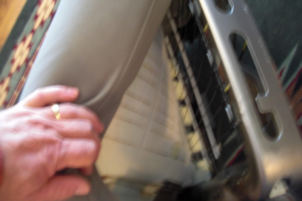

remove the seat, there are 4 bolts on the bottom, the seat back stays attached
there are 2 plastic clips on each side and two on the back and one on the front, lossen them so the metal frame will raise
on electric seats the whole seat frame will not raise due to the power seat controls
there's enough room with one corner lifted to stuff the 15"x17"X2" Nu-Foam Densified Polyester Poly-Fil purchased at Walmart, it fits perfectly between the factory foam sides

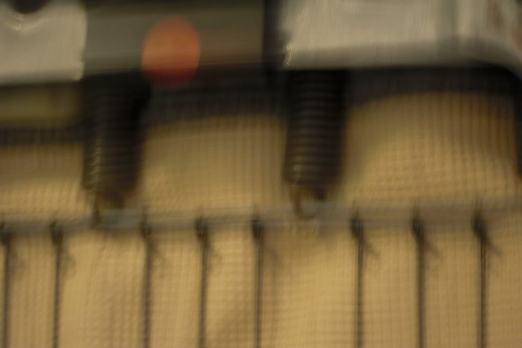

you can also stuff it under the back springs, make sure there are no bumps in the foam and that it is flat

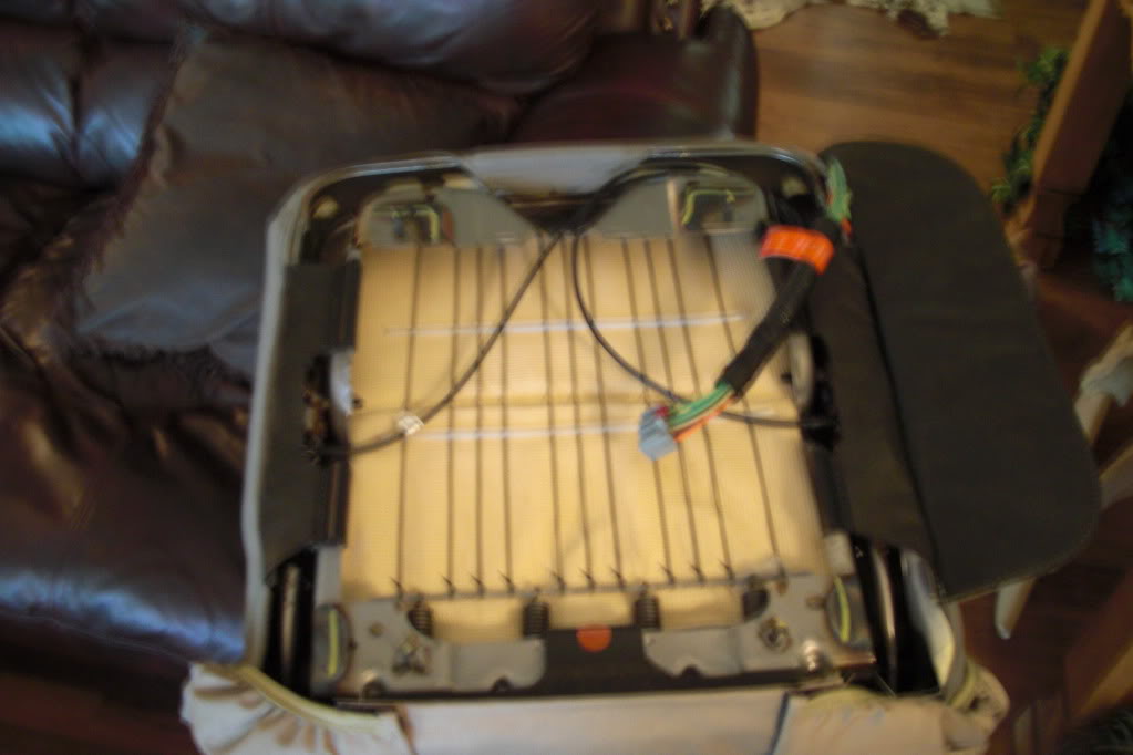

then place a piece of 15"x17" carpet in between the new foam and the piano wires on the bottom of the seat, these wires cut into the foam breaking down the seat over time, put the carpet back against the springs, make sure you have the carpet under the springs at the back of the seat

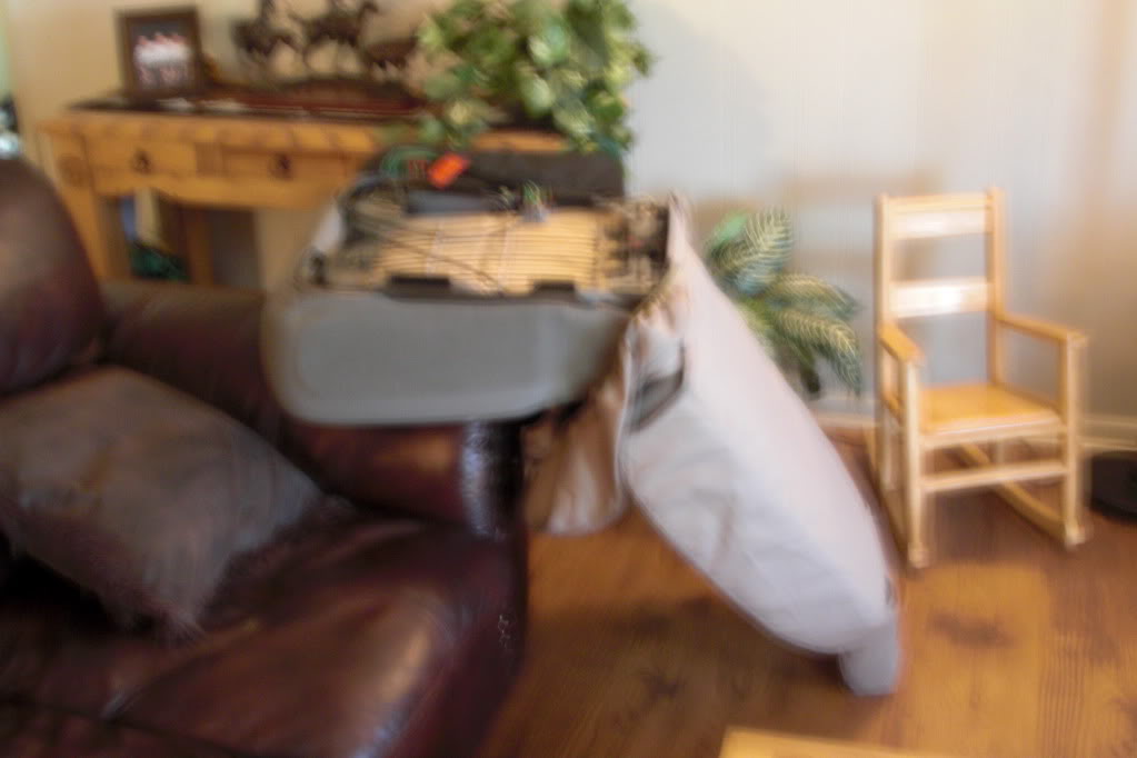

Once you're satisfied everything is even and as it should be you're ready to button it up, since the seat back is on I put the seat bottom on the arm of the couch, rehooked the seat cover plastic pieces to the seat, carried it out, bolted it down and plugged the elec. seat wires in
