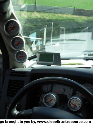

Finished installing my new Quadzilla Commander this weekend. Great package! Everything went well and I only had to probe the wires for the injection pressure. Mounted the display on a fabricated bracket, below the radio (beside the 4 x 4 switch). Did not want to drill holes in the dash in a new truck yet. Also used the trans cooling line hose with the temperature adapter well. I have a question on the commander screen setup-when I set up four readings on the first screen, the same four readings show in all of the screens. In order to get the last two readings, I have to program the two and then they show all screens (I lose the first four). What am I doing wrong?

Big T-If you a gauge person that likes many gauges, I would not recommend using it. However, if you like things in one neat package, its just the ticket. It took me about 4 combined hours. I took the time to tie everything up neat and experiment with connections. I added another test port on the IP to check the gauge, and used the trans test port first. Did not like that and ordered the coolant line with the port for the trans temperature. You do have to drill and tap the exhaust manifold. I greased the drill bits and drilled with the engine idling and the tailpipe partially blocked. Worked great-blew everything in my face (including hot grease....). I also ended up using the middle wire in the plug for the IP pressure reading. As I recall, the wire is brown with a white stripe-I can check if necessary. The wiring connections that come with the kit are good, but I might solder in the future to prevent problems. Bottom line, I would buy again if I had to. People here are a great resource with answers if you need help. Good luck anyway you go!

Nope, The commander will only read 4 settings at a time. To read the other two you have to get rid of two!! That why I have this... There is a total of 9 items monitored at once!!

No, I just have guage envy!!!! My fiance says I have enough guages to measure the barometric pressure in spain Oh well a guage is cheaper than most parts!!!
