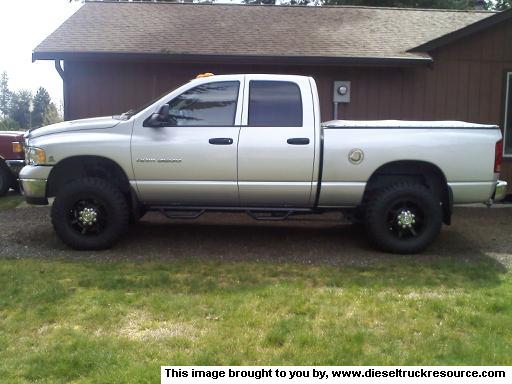

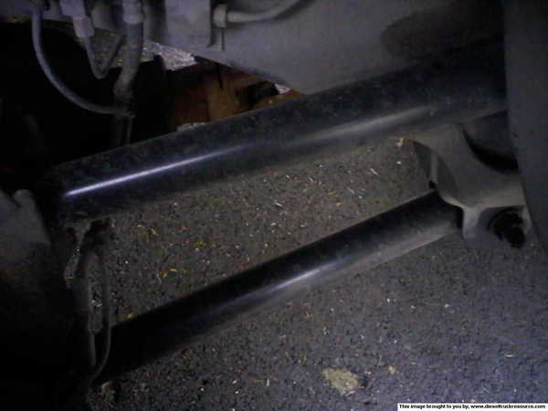

I would put the front on now (or when you get everything) and then do the mini poacks when they come in. I have the same kit without the mini's in the rear and everything is fine. I would also suggest longer control arms and an adjustable trackbar to make everything nice and centered.. IMO....

the drop blocks are for the swaybar. longer control arms will push your axel foward to recenter it after raising the front. the adjustable trac bar will allow you to center your axel left and right. These are not nessessary items for leveling kit it was just a decision I made when doing it. if you measure everything before and after the install you will know why these are options. adjustable tracbar are aroung 300 buck or so. the control arms about 250...
