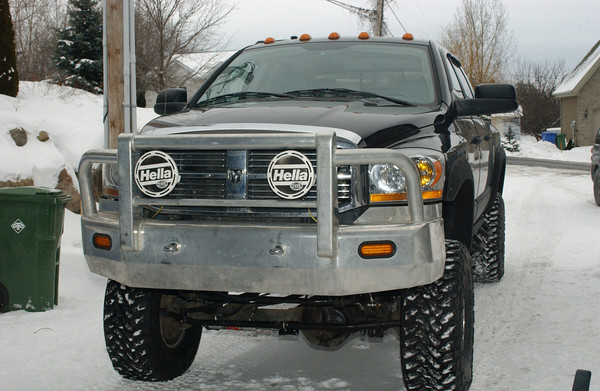

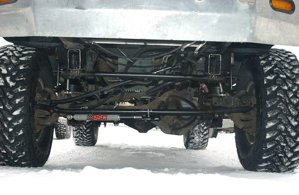

The suspension is pumped up on this photo... imagine it about 2-3 inches lower..
It is done... for now.

Sounds like a sweet system and looks awesome. Does the change in height from 3 to 6 mess with the alignement and steering? Any vibrations at the 6 height. Maybe the 6 is just for off-roading so the change in steering is negligble?
Those systems are pretty pricey aren't they?

I bought it used. Got a good deal. There are some used ones for sale if you dig around.
I will have it out today. More driving impressions to follow.

Answers to questions.
When you inflate the bags the steering wheel is to the right of center when full height and left of center below the ride height.
Slight rear end shudder at launch... but that is due to the terrible 2 piece driveline (ordered aluminum one piece from dodgeparts.com)
I wanted to be able to adjust for load... not so much height. So it seems to ride really well so far. Just being cautious about beta testing it. I have a bad bushing on the right lower front control arm that is being sent from Kelderman (great company to work with). After that I will role on the coals.
