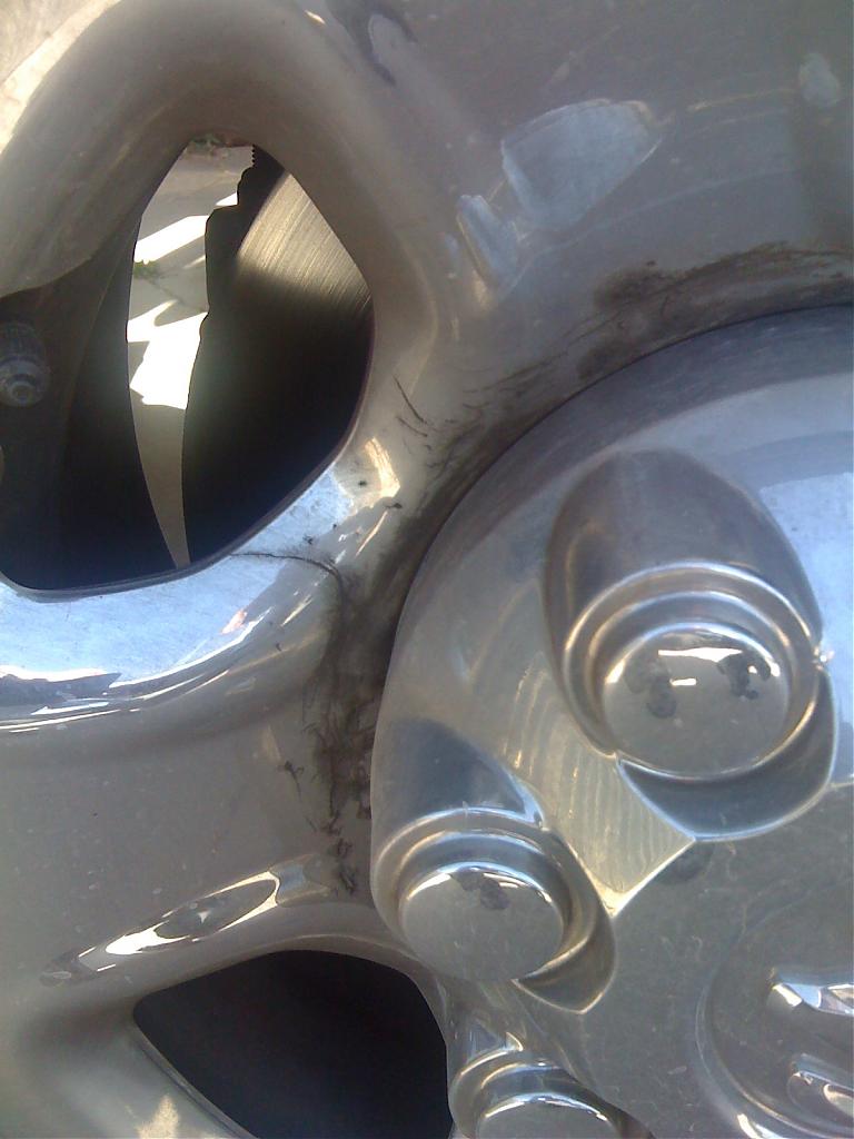

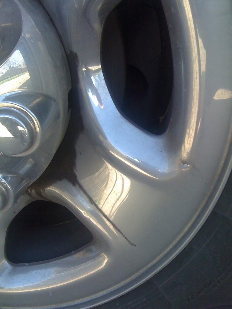

Guys,
Help me out here... I've got grease coming out from under my hubcap. I popped off the cap and can't see the grease source. I'm running 37" tires on stock steel wheels and everything feels good.
Somebody let me know what's happening.
Attached Thumbnails Grease on left front wheel-img_0547.jpg   Grease on left front wheel-img_0548.jpg

Have you tried to grease your wheel bearing lately? Or do you use Never Seize? Is it the front or rear?
I leaning more towards wheel bearings are about ready to go. What you are seeing is grease that got warm and found a weak spot in your hubs seals. I would start ordering new hubs or hubs like the Dynalocks or Spintec.

Thanks. I'll try to check wheel bearings this weekend.
It is the front, driver side. Any other thoughts?

^^^^get ready to do hubs, been there many times, not even a second thought soon as u c that grease spot its hub time. just got a timken from
http://www.amazon.com/Timken-HA59003.../dp/B000IYCSLW for $165 with shipping got it today it came in a timken box but has skf stamped on it and its made in mexico.
