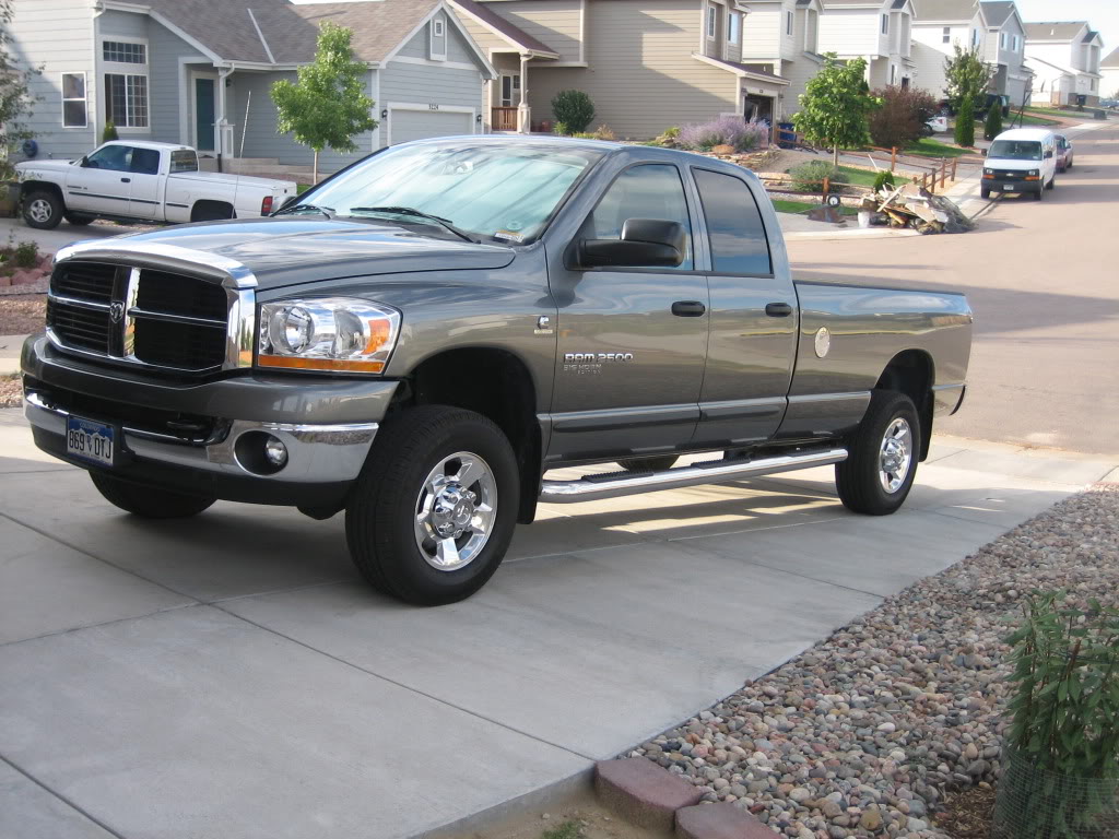

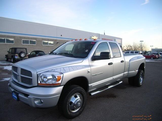

I converted mine... I took my mineral gray 2500 down to the dealership and had them convert it into a bright silver 3500 dually!! [director]
Attachment 69563
Attachment 69564
Fordzilla Feb 28, 2010 07:41 PM
I'll bet they even zeroed the odometer for you...[coffee]...Ben
Lost Lake Feb 28, 2010 07:42 PM
[QUOTE=kaywt;2713595]I converted mine... I took my mineral gray 2500 down to the dealership and had them convert it into a bright silver 3500 dually!! [director]
LOL ! Quite a nice conversion!!! [coffee]
