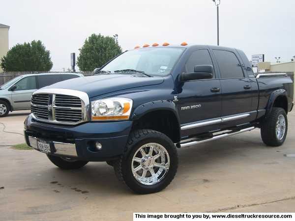

06 is getting a 4.5 lift kit (Fabtech with Pro-logic 4.0 shocks) this morning!
Jesse James Wheels 20x10 with 35x12.5(13)x20 Toyos MT.
Originally, this is the setup I wanted for the 06:
Unfortunately I had problems with the Extreme tires (Balance). I liked the Extremes because of the thread pattern and how wide (13.5) they are for 33" tire.
If you follow the general guide that PTGarcia wrote, you will be ok.
Here is a configuration on 33" that looks great (in my opinion)
Last if you have a chance to stop by a Wheel/tire shop, ask them if they can mount a 35" tire on a wheel that fits you truck (8x6.5), not balance needed,
Install and see where you at, you probably have to pay some labor.
The reason I am suggesting this is because the rubbing on one side is not the same as in the other side, in my case the difference was as much of 1/2 an inch.
I also read here somewhere that you can move the fender panel like 1/4 to 1/2 on an inch back.
Hope this helps, now go get them and keep us posted!
