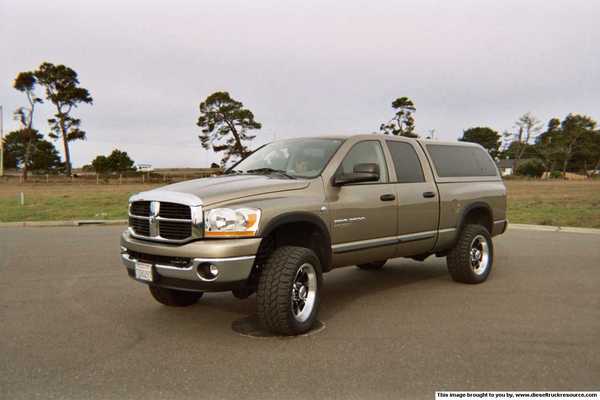

Xtreme ATs on Jesse James
Check out this combination:
West Coast Choppers Jesse James 20x9.5 wheels
Pro Comp Xtreme ATs 10 ply 325/50-20 (33) tires
They look as if they were made by the same designer.[IMG][/IMG]

nice,, what exhaust do you have on there? Does pointing it out the back help with drone??

i have been looking at those rims for a while now i have to say they look awsome on there.

They look pretty sweet, but I'd prefer a little more rubber. Same size, but in at least a 35" tire, maybe even a 37!

I was almost decided on the same setup. Thise are sick. Im still researching 22s with 33s though.

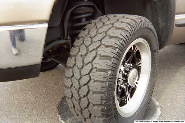

It is a giant Magnaflow (36") with the cat and a 6"x 24" tip.
The tip is not pointing out back, is more to the corner (see the photo below). I have them welded like that so when the truck is on and in the garage the fumes go just outside and not against the wall.
I don’t have any drone, I was told that if the tip reaches the outside of the bumper is less of a chance for drone, plus the truck stays clean.

I like that alot. I really like those tires. Thanks, now I gotta get some next spring.

are those tires noisy?

Hi everyone thanks for all the compliments!
Additional Info:
The tires are directional (Can only rotate from front to back and back to front)
The drag from 12.5" wide tires to 13.5" is noticeable
Tires are very hard to balance, doable but difficult
Noise level is like BFgoodrich AT
Tires are so wide you can't go bigger than 33" with just a leveling kit
At 325/50/20 the tires are taller than Toyos 33"s and Nittos 305/55/20s, go figure the standards on tires measurements.
The Wheels are 9.5” wide, with a +10 Offset
