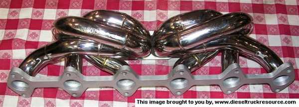

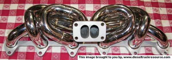

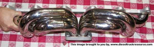

found this in "cummnz4x4pwr" photo gallery. Talk about a pimp header!!!!!!!!!DROOOOOOOOL
stumbled across this while searching
this is for a 2nd gen
No kidding man that is killer!!!!! If you need help just call me... Heck I might even drive up to work on the truck with ya!!!!

The 3 piece 2nd gen manifold is centered on 3 and 4 cylinders and exits at about a 35degree angle from the manifold so virually any turbo will mount as the top turbo....The 2 piece 3rd gen manifold is centered at 4 and 5 cylinders and exits straight up so a big turbo will be very close to the hood (or through it) if you don't mount with an adapter plate. I used a 3rd gen with an adapter so that I could mount my Tial external wastegate....there may be some pix in the gallery. This piece and the hot pipe were brutal to fab as it tied in the waste gate, turbo, manifold and big turbo together in a very tight space....It worked put awesome...but if I did it again I'd try to tuck the big turbo closer to the block and up a bit as I had 1/8" clearance on the stupid shock tower.... Using the 3rd gen makes everything up high and visible. Kerry
