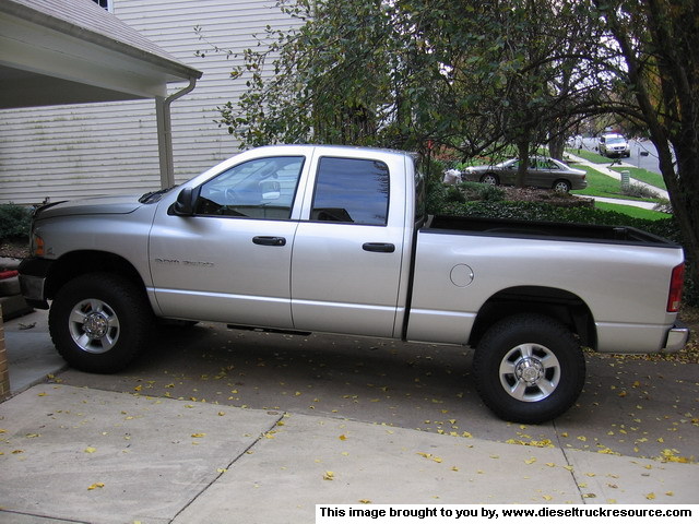

Not that it matters but I figure I'll post my pics anyway.... no leveling kit, stock alloys and BFG 315s. When these wear out I'd really like to find some thinner tires that are the same height. Something like a 285/85R17. Or maybe I'll just move up to 19.5s
(I know, bad pic)
