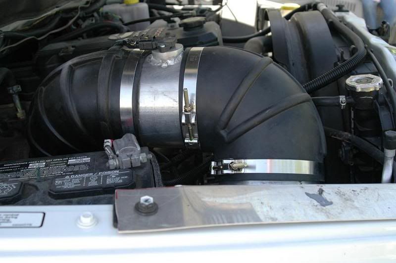

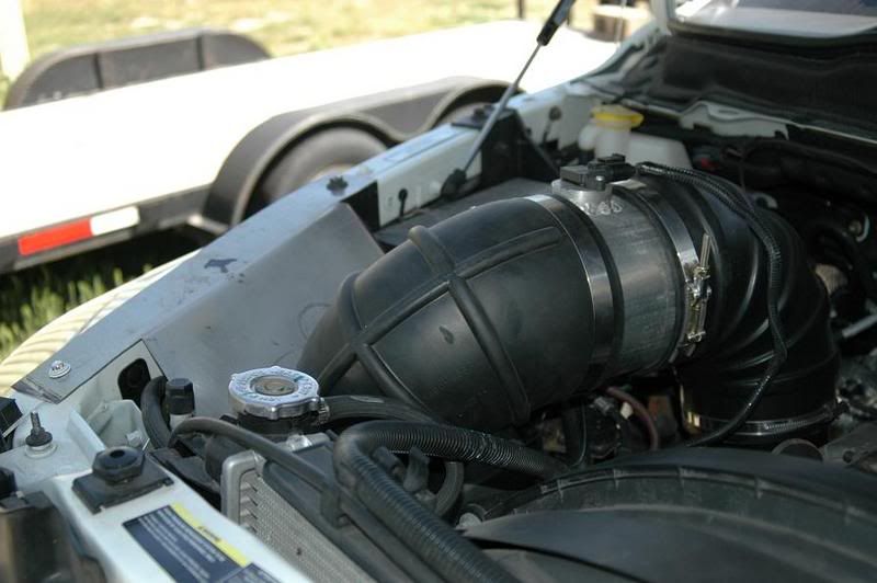

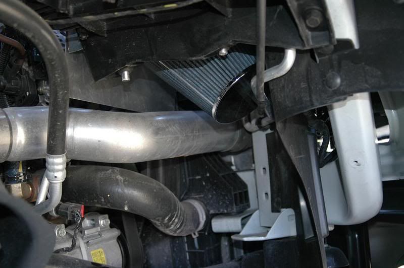

Well I have a few teaser pics of the whistler stage II set-up...
now keep in mind this is just my prototype version and I have not made any of the lines smooth or clean....I also used some really thin aluminium because I wasted to other good pieces, so the next one you guys see will be A WAY CLEANED UP VERSION OF WHAT IS SHOWN.
let me know what you think
here is a shot of the filter way down in the fender well... nice and cold down here
so when I posted this teaser I forgot/didn't think about the guys who have done stage I....If you move to the stage II intake you need to make sure you order this rubber elbow.......
90* short radius elbow Not the standard radius
I am sorry if any of you guys already ordered... I just thought about it tonight
