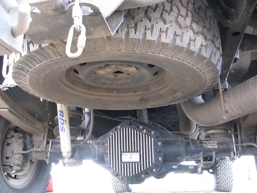

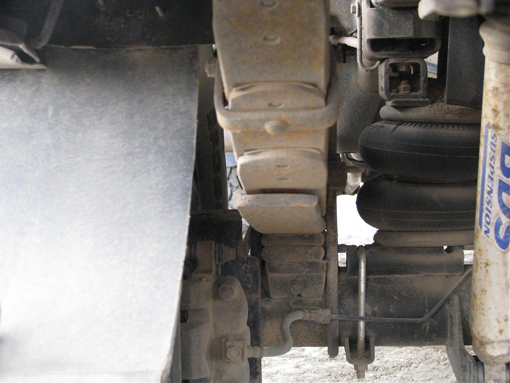

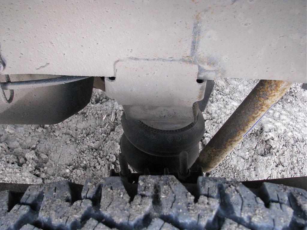

Mine went right in no changing anything. Ill post some pic in the next hour or so.I too thought i would have to build some brackets but nope went right in ad they keep the truck riding right with 1100lbs of tools in the back.

Here are some pics of my setup.

Is that with the body lift? Even with only 2 inch spacers there was no way the airbags were going to work without a new bracket on mine. The distance between the top of the axle and the frame increased by 2 inches with my lift....

Yep i have a BDS 6" suspension(4"rear springs,no blocks) and i had no spacer to put in there and they work awsome. I carry about 1-1500lbs of tools all the time and a 5-12k trailer every few days. No issues so far and i have had them in for about 70,xxxkm now.
