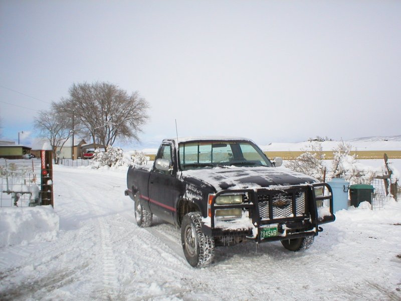

If you had hit the same deer with your truck/bumper I bet it would have still done at least $500 in damage. Have you ever seen one of those aftermarket bumpers get pushed into the hood/grill/fenders? Maybe if the deer went under the truck it would cause minimal damage, but not if it hits higher up on the grill guard part.
Oh, I don't know about that. I dead-centered a muley doe with the old Chebby at about 50 and it didn't bother that Texas road hunting bumper (Brush Buster brand) or the truck at all.
