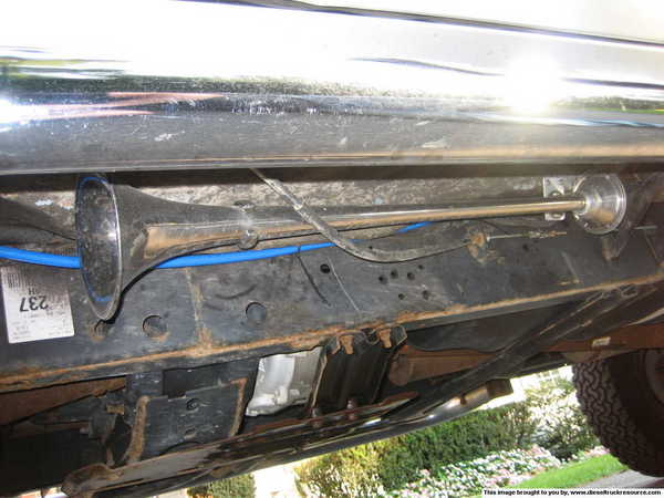

HorseHauler,
That looks like the perfect location for the ricers that tend to drift into the side of us on the freeway.
That is under the front bumper isn't it”?

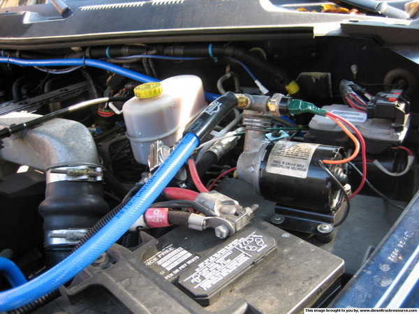

My horn as a Grover single trombone and has a deep tone, I have it mounted under the floorboard on the drivers side right under my feet.
At 70 MPH with the windows up even with the radio on, you cannot only hear the horn but you can feel it. I have my compressor set to cut out at 140 PSI.
I got the tank off from a semi tractor and welded a bracket so it is mounted on the passenger side bed rail, it fits tight between the cab and wheel well
The compressor is supposedly off from a Lincoln Continental, I tested it and it will pump 200 PSI and only get warm, this is also tucked up next to the air tank. The pressure switch I got from Grainger’s to cycle the relay that powers the pump motor. All of the lines are 3/8" & 1/4" nylon nyflex air brake line.
My future upgrades are going to be replacing the compressor with a Thomas compressor like the ones used on the Hummer CTIS systems and to add an additional secondary air tank for more volume.
I found out that the plastic Grover lanyard valves would tend to leak if you have much over 150 PSI for any time but they do make a brass unit.
At 150 PSI these horns are LOUD...

well i have a VERY temporary setup haha. I have 1/4" line coming into the cab with my 1 gallon air compressor used in our garages sitting in the back seat pre-filled. hold the nozzel to the tube and blast haha. Not as loud though with all the tubing between the air source and the horns but it gets it done. I really need to get this finished
to the above post, yea it is mounted under the front bumper.
