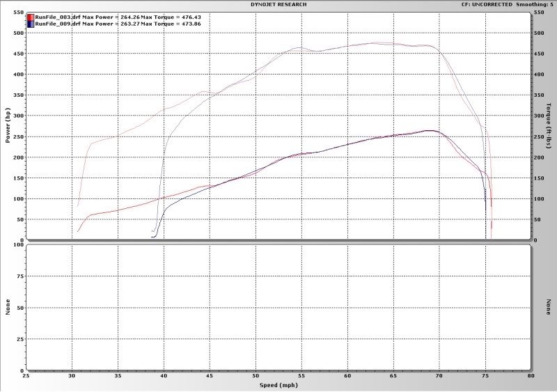

Here is a graph of my truck that was run twice when stock. The first run was done on 9/14/04 the day after I bought it. The second run was done 3/18/05. As you can see, the Dynojet 248 I ran on was quite consistent even though it was more than 6 months apart. I ran my own truck personally so the operator had nothing to do with it. Both times I just mashed the go pedal once I hit a green button on the dyno remote and this was the result each time. Now that I'm pushing for 700, and am darn close I might add , I find myslef hitting the brake down low at each run to get boost up. No matter how many runs I do I hit max boost and it maintains it througout the run. I run in 6th gear now as opposed to 5th or 1:1 gear ratio on a NV5600 and can keep consistent boost numbers. I have run on other dynos and I just choose a Dynojet each time as they are the easiest to run and most consistent by far. They have their ducks in a row and they are on top, way on top, for a reason.
Uncorrected numbers

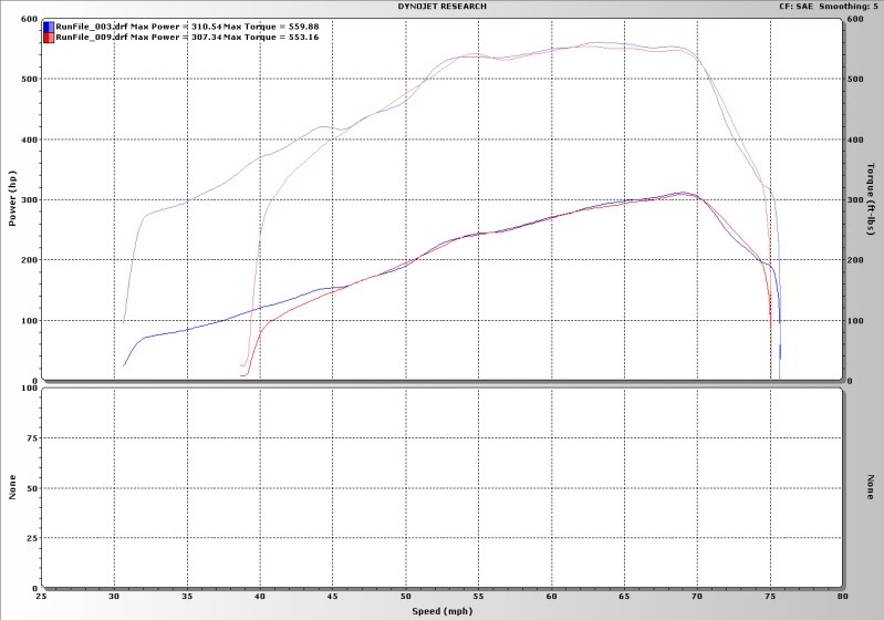

Corrected to SAE numbers, same runs

Staarm, to compare across that much time, you should probably show it with SAE correction to account for temp/humidity variance. Probably won't change much, but if you don't someone will call BS!
Edited my post to show both SAE and actual numbers for same runs.

Dang, Son! It must have been HOT and HUMID that day or you are at some serious altitude
4600 feet. Correction factor is usually around 1.18.

Ouch, that is brutal! I would imagine that 62 is even pretty smokey up there, eh?
Yep, she's a little smokey down low but the pressure box and some timing helps a ton.
