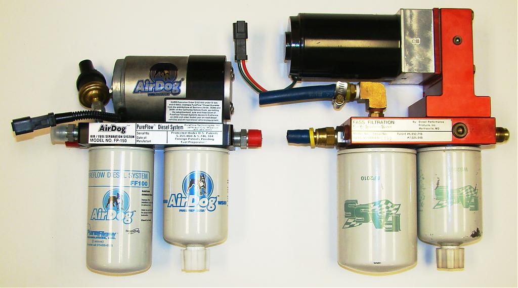

Originally Posted by AirDog
Heres a couple picks of our 150 gph next to the FASS 95 and 150.
Do you have any data showing a mpg improvement ? Or are you just assuming with a better supply you will have more efficiency, therefore better fuel economy ??
