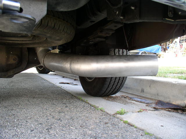

so with a 5 inch turbo back, do you lose the cat? i have mbrp 4 inch but looking to go to 5inch. the 4 is not much louder then stock i think and am looking to drop my egt.
Old Jan 16, 2008 | 12:35 PM
bekim's Avatar
Posts: 473
From: So. Cal.
Cool
Some kits come with couplings to keep the cat inline, some don't. If the cat should happen to be left out(which is illegal) hold on to it. For me, the EGTs were a solid 100° lower with a 5" system. Cool down times were also quite a bit shorter after a hard pull. I have a 4" Silverline system(very similar to the MBRP, and I can tell you in no uncertain terms that the 5" system was MUCH louder. The muffler delete plays a huge part in the noise level. A straight thru muffler hardly does any muffling IMHO.
Mike
