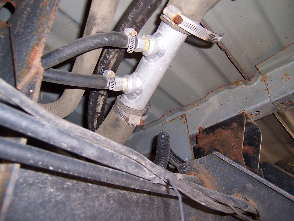

The setup would work trouble free if you simply use the auxiliary pump you have to pump fuel into the main tank. That way ALL fuel is fed to the engine in the stock method. I did it to mine. Just cut the filler hose and install a tube with 2 ports, one for feeding fuel from auxiliary tank and 1 for the return back to the auxiliary. That way if you forget and leave the auxiliary pump on the fuel is fed back to the auxiliary tank. I put my switch down under my center console so that it has to be up in order to pump fuel, with that I rest my arm up on top of it as it pumps and it is out of my "normal" driving position. It takes a little while for the stock tank to be filled and its easy to forget with driving, radio playing, cell phone talk,etc. I also have a guage for the auxiliary tank mounted next to the switch. Here are pic's of mine...

I was planning on doing that, exactly what you did if the seperat system dosen't work. I wanted a separate system so if you have a fuel pump failure or any problems with the fuel you would always have a complete separate system. I have built several tanks and always hook them up separately. I am going to try to hook it up separately and see what happens? I have to make sure that the amp draw on the OEM fuel pump is the same as the auxiliary fuel pump. The Auxiliary fuel pump on my 03 draws 5.1 amps with the engine off and 4.5 amps with the engine running. You can hear the change on the pump when the engine is running. Thanks, Kyle

OK it's all hooked up and I am useing a carter 72 gallon an hour pump. The amp draw on the OEM in tank fuel pump is 5.6 amps, the carter is drawing 3.6 amps. I cut the fuel line wire that feeds the in tank fuel pump and installed a 10 amp fuse on that wire for powering both of the pumps when the switch is fliped to tank 1 or tank 2 . Ths sending unit is 240ohms empty and 33ohms full, it reads corectlly on the OEM dash guage with both sending units.
