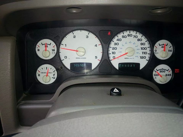

My 05 2wd, the Bully Dog set at 90 hp has been on it since 54,xxx mi. Not one issue.
The pic may stink, that's 327,000 mi.
My 05 4x4 compound only has 92xxx, Bully Dog set on Crazy Larry since 55xxx mi. Not one issue.
Both boxes were bought used as well.
