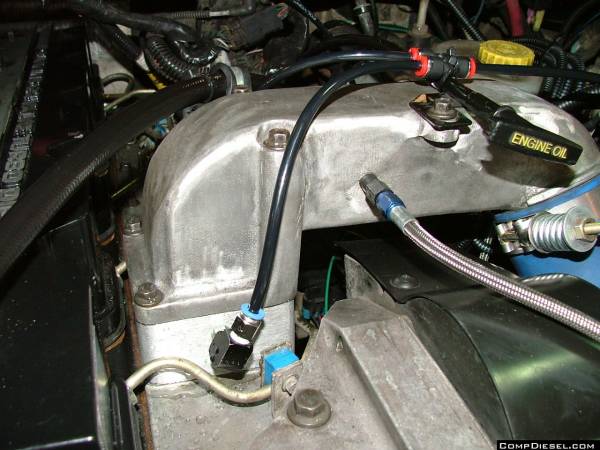

Here's what I did with my new grid heater delete spacer. ....and no I don't use the nitrous nozzle that's upstream from the water nozzles at the same time.
