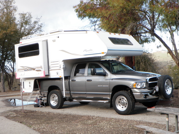

Nice rig! that is also a pretty sweet looking camper. Let me just throw this out there..... have you considered doing a DRW swap? The difference between DRW and SRW for hauling is night and day. That truck might look cool with some mega cab fenders.... Also, if you don't have a rear sway bar, that makes a huge difference. I've seen them on ebay cheap. For the front, you could get some of the thin wheel spacers that don't bolt on - but I'm not sure how much wheel stud thread you have left with those wheels. It might not take much at all to help with your rubbing problem. Another cure might be a small coil spacer - maybe 1.5"? that and an add-a-leaf for the rear. I doubt an extra 1.5" of height would mess any of your plans up. Just a thought. As far as the bolt on wheel spacers, I've used them on my last two duallies, but never in the front. I can't say anything bad about them, but it seems scary. However, I don't see the difference between that and wheels with less backspacing......

I am already running 19.5" wheels and tires with a H load rating (4950lbs @120psi) so I don't think that I'll be doing the dually conversion.
And... I have a beefy RoadMaster (anti)sway-bar in the back and also have Firestone airbags and extended bump-stops so that the overload springs engage sooner. My rear suspension is good to go!
I am getting the message that spacers are a BAD idea.
