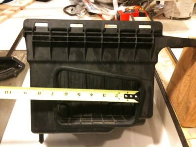

Originally Posted by msiminoff
I am always so surprised to read these air-box mod threads.
Given the size of the opening on the stock box (see pic' below) compared to the rest of the (3") intake tract, and the fact that the stock inlet goes through the fender and directly to the front grille... It is hard to imagine that opening the bottom of the airbox (swiss cheese or HomeDepot style) to the low pressure & HOT area under the truck can provide an improvement in flow or IAT. Especially for those of us in the sub-600 category In addition, while realize that the chance of water or debris getting in there is slim, it's not worth the risk especially when the factory system is as good as it is.
I AM inspired by ThunderRoad's scientific approach to measuring the difference! I am curious to know if those measurements were taken while driving or on a dyno' ??
I have a manometer too (plus new and old style air filters and a spare airbox) and I'm going to put a port in the lid of my airbox and run a few comparisons while driving. Will post the results here when I am done.
Cheers
-Mark

Originally Posted by BigDogJeepin
The factory opening in my '06 box was about a third the size of yours.
I'm surprised there's a difference.
What? seriously? I thought 05's and 06's were the same!
That is shocking!
Can anybody else confirm that their airbox is different than the one in my '05??
Cheers
-Mark
The measurements were taken in the lower "box" not thru the "lid". The restriction of the factory "air inlet" is all I was testing for, not the air filter.
The opening in your box looks to be the same as mine.
Ok thanks ThunderRoad, that is helpful! Can you tell me where (exactly) the measurements were taken... did you drill a hole in the lower box? or was the hose from your gauge placed in the fender?
As I mentioned before, I'll be measuring the pressure in the upper part of the airbox... after the air filter. I'll build an adapter so that I can plumb into the filter-minder port.
Cheers
-Mark
Cheers
-Mark
My factory intake is only half that size.
MikeyB
MikeyB
I'll have to measure mine tonight, take a picture also.
MikeyB
My 07 is the same as pic.
