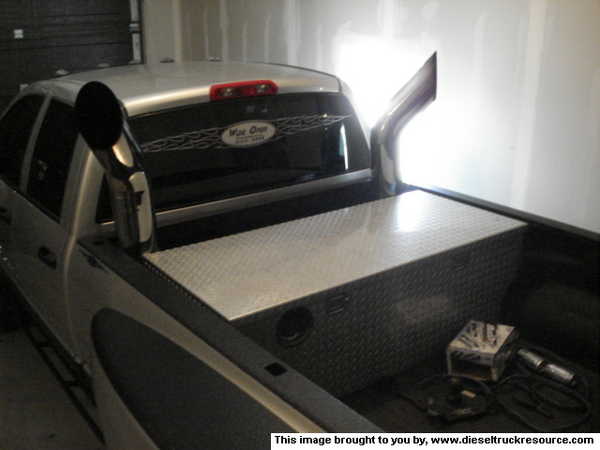

i'm waiting on my stacks to get here right now. i already have a toolbox and instead of moving it back and losing 5 more inches of bed space i am going to build a mount out of 1/8" sheet metal to go over the y pipe and put a drop in box on top of that. so that way i stay with the bed space i have now. just a thought if you want a tool box. but i have seen some guys (maybe on the diesel stop) with a setup kind of like what you are talking about except the tubing is on the top side of the bed. they are doing that then mounting the toolbox straight to the tubing. i know you didn't say anything about a toolbox but its something to think about.

ya i do have a tool box( i guess i forgot to mention that) i was thinking of sliding it forward or maby modifying it so it fits in tight to the bed and over the stacks.
