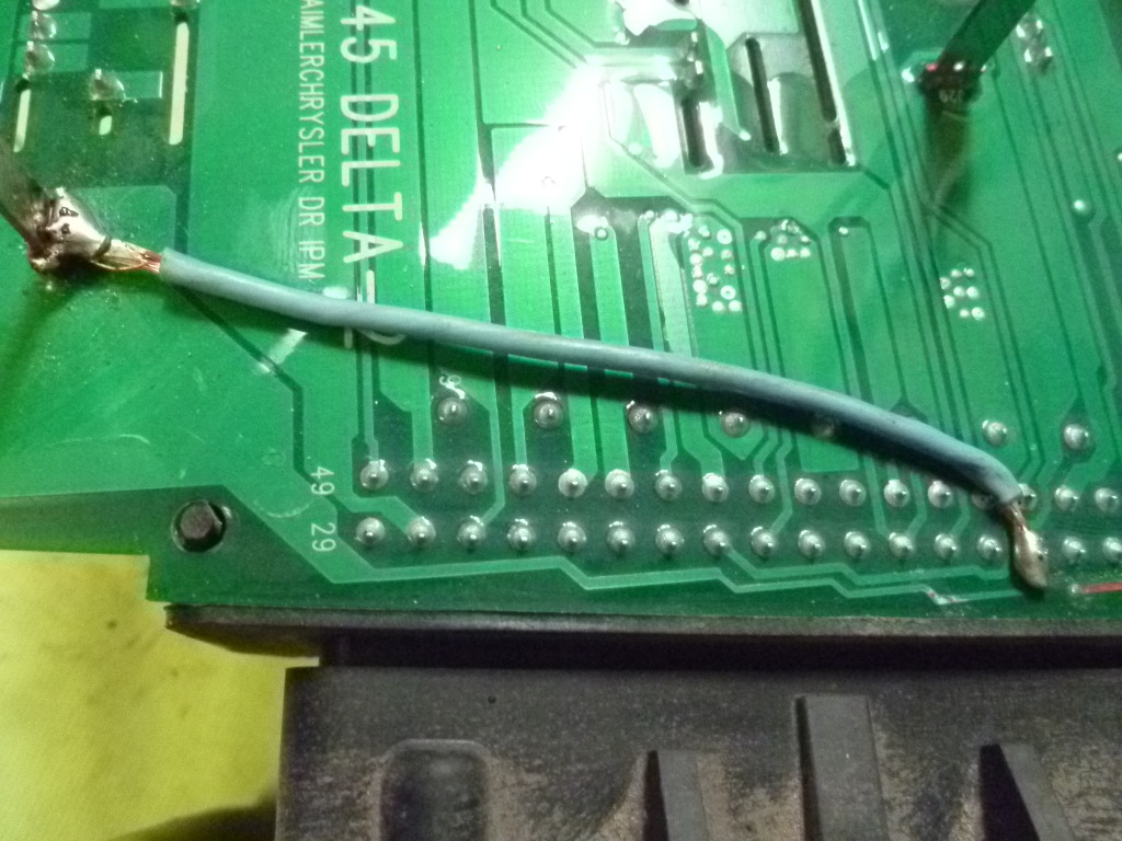

I tore into the PCM to fix the "no tail light" issue the other weekend. While in there I cleaned up various pins of corrosion and noticed a few questionable traces.
I jumped the tail light trace and got them to work again, but yesterday (after about a week of working fine), the truck quit on me and will not start now

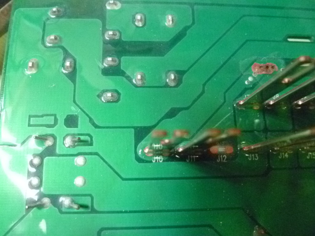

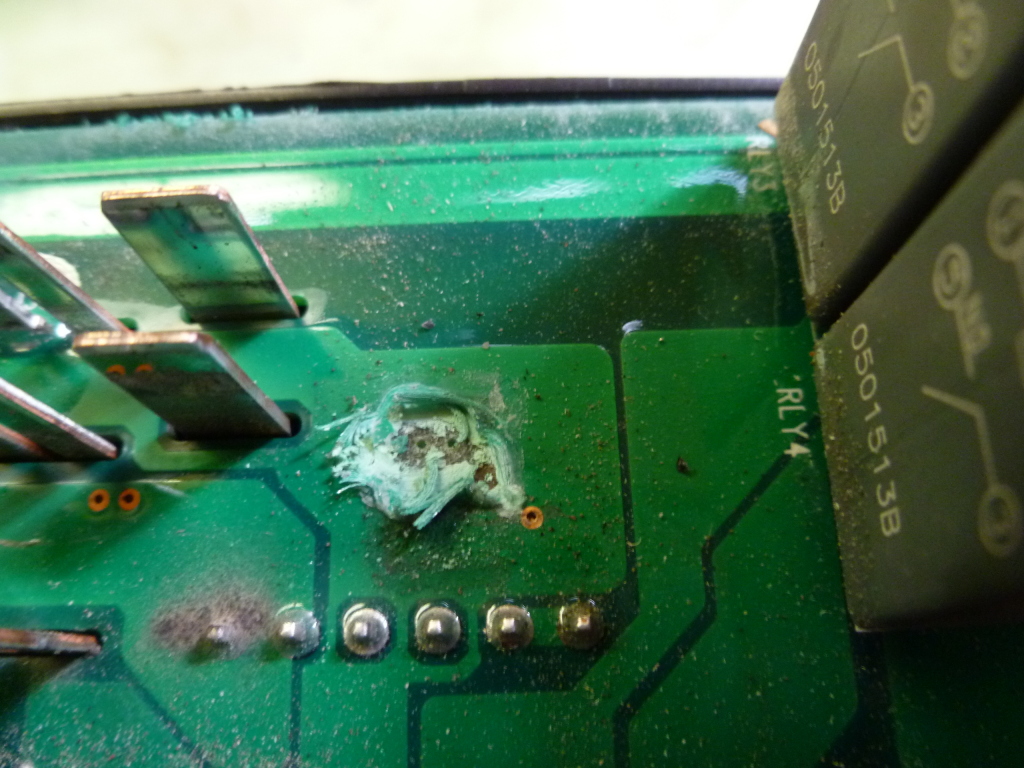

Trace leading up to pin J11 on the board is the one that looks like it exploded at one point (see my pic). That one leads to power outlet-console fuse, so I can see why it looked like it did. It shares a lead with other traces though, and I just can't track them down to any of the connectors on the back of the box. It might be something as silly as a loose pin in the connector itself...question is which one(s) control the fuel delivery.
