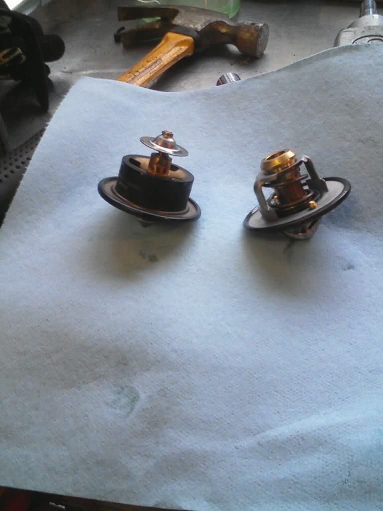

do you notice you have more heat when the heater fan speed is low? and as the fan speed is increased the heat output decreases, if so the heater core is plugged another key is the type of thermostat you installed if its an OEM style it has a plate on the bottom that redirects coolant thru the core, if you used aftermarket while you might show 170-190 on the gauge, there is not enough coolant pushed thru the heater core, infact the fan cools the heater core
here is a pic of the thermostats, OEM on the left aftermarket on the right.
downside of the oem is it does cycle up/down 10+ degrees, it will outperform the aftermarket thermo in the heater output dept.
I think you labeled those backwords. At least my OEM and Genuine Cummins stat look just like the one on the right.
The reason they swing is part of the design to support light and heavy cooling needs. The 3rd gen stat cracks at 190° ± 3° and isn't full open until 207°, so swing is normal.
oopsy, forgot I was in the 3rd gen forum, the picture is correct for a second gen stat. the temp swings in a second gen is 10-15* will swing from 195-180 all the time, yet produce more heat than the aftermarket stat even though it stays at a constant 195.
