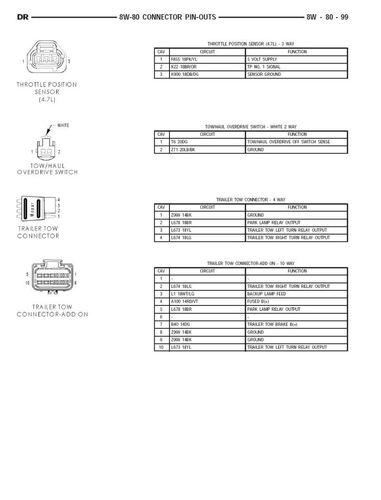

anybody kind enough out there with a shop manual to let me know the wire color/colors for the tow haul (button) for an 04.5 48re. thanks

Color code color
bl blue
bk black
br brown
db dark blue
dg dark green
gy gray
lb light blue
lg light green
or orange
pk pink
rd red
tn tan
vt violet
wt white
yl yellow
* with tracer

thank you very much. thats a big help. i appreciate it!
