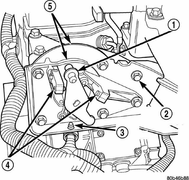

people call it the apps pps tps and the dealer calls it a bell,crank accel &and cruise sensor does any have a pic of it and where its located at the dealer doe not know where its located on my truck thanks for the help

On the 04.5's it could actually be 2 places. Most of them are mounted on the engine in the attached pic. The others are under the dash. If yours ins't on the engine, follow the cable from the pedal under the dash to wherever it is mounted. IIRC, it could be inder the battery tray too?

where is that part located at

I think that pic is showing right in front of the intske horn.
