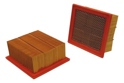

Originally Posted by surfram
I have been running these for over 100,000 miles. I usually change filters at 15,000 miles but I have run them to 20,000 without the filter minder moving.
The 9946 is a huge upgrade in dirt holding capacity but the initial flow rate is identical to the 2846 at 675cfm. A 2790 BHAF is rated at 680cfm. For essentially the same price of 2" pleat filters, the 4" pleat 9946 has everyone beat with a high flow rate and long service life.

I found the big one at Summit Racing, Wix brand, it was the better priced of them all.
