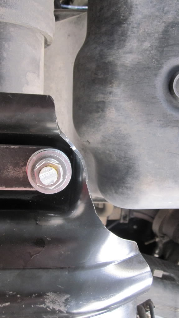

This is looking straight up at the cutout included on the updated part and the oil pan. Tested it on a rough trail with no problems. So make sure you order the updated part number and you will not have to cutout the corner like the previous posts.
