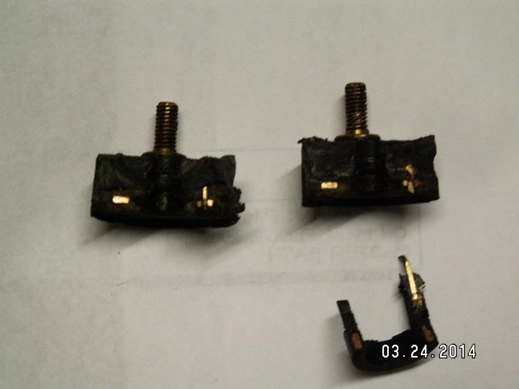

you can just replace the solenoid without removing the injector, it only takes about 20 minutes total time. i think the wire nuts are 8mm and the deep socket is 1 1/8". there is two different suppliers on the internet, i have used both of them. if it is over 1 ohm it will be intermittent this was a design flaw on how the post's were connected to the coil, they used a wedge pressed into a split ring for contact, i cut one into at just the right spot to be able to observe the fault.
