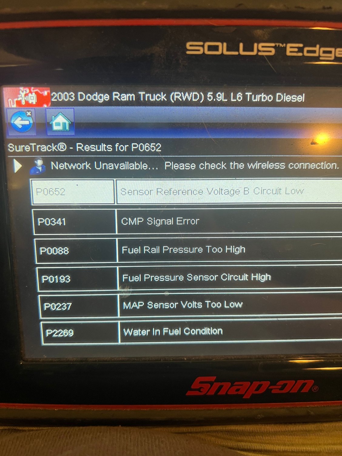

Hey this is my first diesel I got a 2003 2500 with 162,000 miles got it a month ago and it ran fine here lately I can be driving down the road and it will start to sputter and die, it throws a check engine light and a water in fuel light, I scanned the codes with my snapon scanner and this is what I got P0652, P0341, P0088, P0193, P0237, P2269, P0340, P2266….. it will throw all of those codes and with in a couple days they just go away and truck will run fine again until it does it again. Yesterday it did it again but this time I
can’t get the truck to start again, it will start for a minute or so and acts like it’s running on one cylinder, knocking, shaking the whole truck then will shut off, any help would be appreciated Im completely lost on what to do

I dont recall the codes but I had a crank sensor go out and it had the same symptoms. Also check the plug into the sensor located at the front of the oil pan on the pax side.
