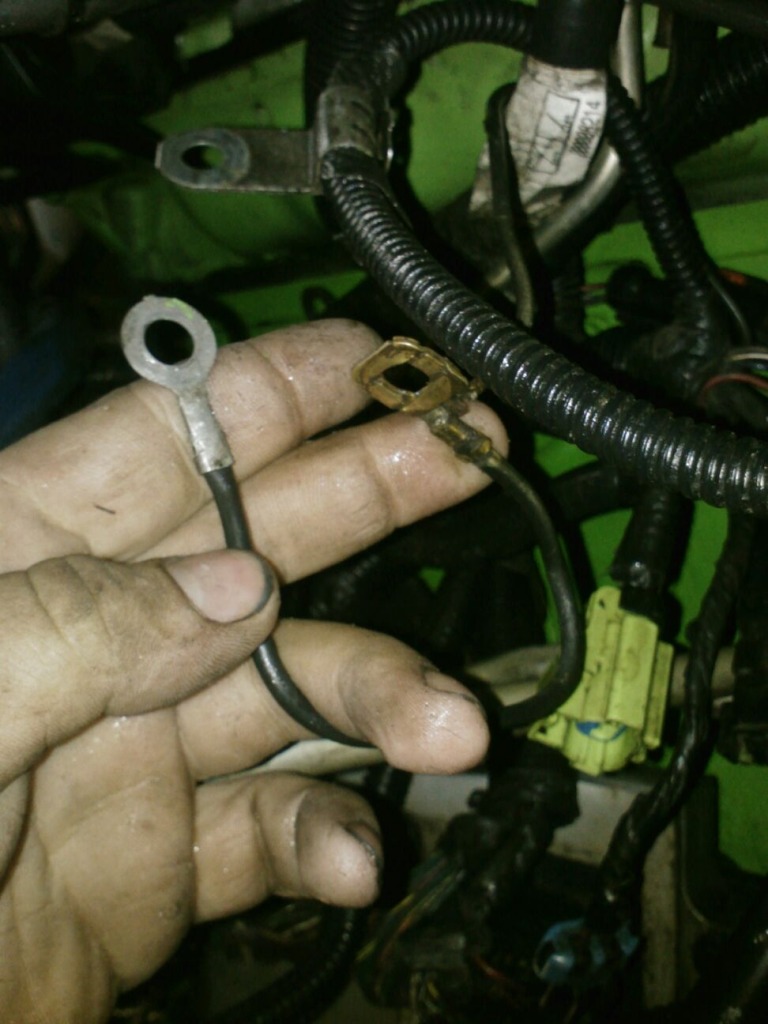

well ive gotten just about everything buttoned up. got a buddy coming over tomorrow to help me figure out why my fuel pump isnt kicking on and i still need to figure out where this goes

well my buddy came and helped me work out the electronic bugs with the lift pump... the lift pump kicks on now and i took both of the wires in the last pic and grounded them to the block and the engine turns over but it still wont fire. i cracked the fuel lines open to #1 injector, the fuel supply to the pump and the cp3 line to the fuel rail.
