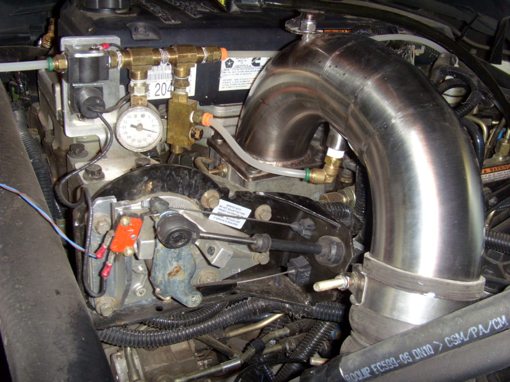

I made an intake manifold tube for mine and put a pressure tap port in it. Works good so far.
