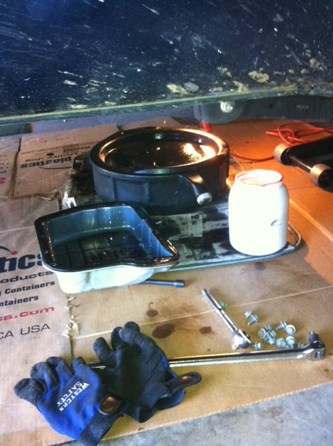

Well, I suppose I should give my update. Yep, I planned on dropping the pan and checking things out. I ended up installing a dorman pan ($44) that had a built in drain plug. I connected a long section of aprox 3/8" maybe 5/16 OD hard plastic tube to a cheap rubber siphon bulb pump down the tube. It wouldn't drain, so I ended up pumping just shy of 3 quarts out. Only took maybe a minute or two of pumping, not bad. I did time each pump with my thumb plugging the end of the tube so it wouldn't suck any air back. I dropped the pan and only spilled three drops when I wasn't paying attention. Avoiding lots of splatter was my goal, I'd say mission accomplished.
I adjusted the rear band and it was either that, or the 6.5 quarts of new fluid that really made the shifting better. The next night I adjusted the front band and that really didn't seam to do much. After adjusting the rear band, I thought I should have counted how many rotations it took to get to 72 in-lbs. Wish I would have. So on the front band, I counted and it was almost 3 rotations to tighten it down, vs. the 1 3/4 that the factory book says to reverse it.
Feels pretty good getting some new fluid and filter in there. Now with the drain, I might just swap in another 6-7 quarts in a month or two just to get some more fresh stuff in there since I think my truck has 50k miles on it.
