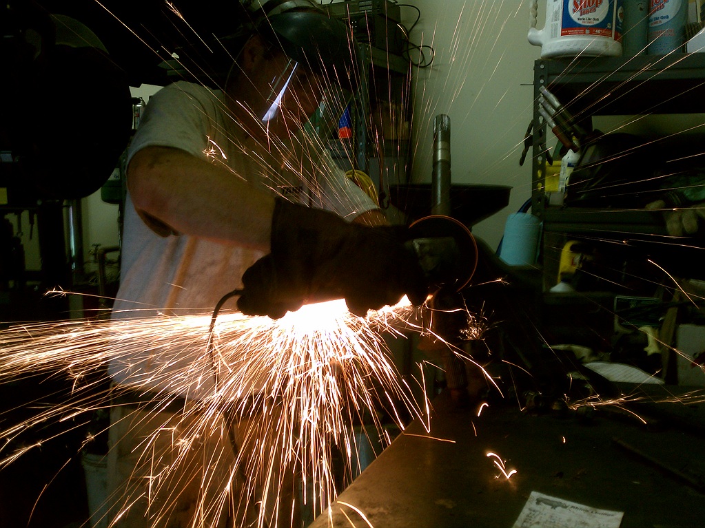

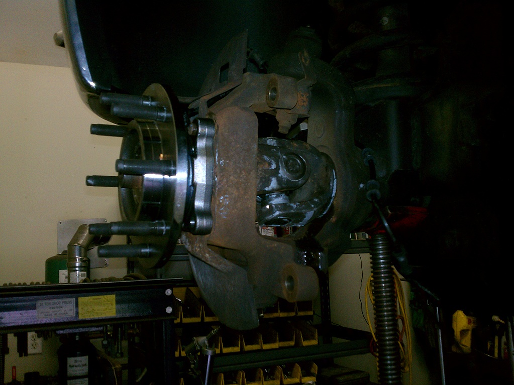

Finally got the U-joints done a few months ago. Also replaced the hub bearing assemblies. Thanks to my friend Aaron who's got a lift and the right tools, it went without a hitch. He cut the old joints out with a radiac.
http://www.youtube.com/watch?v=XGUqAp6Q6WY
