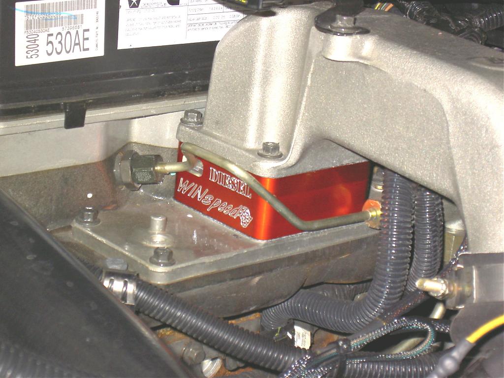

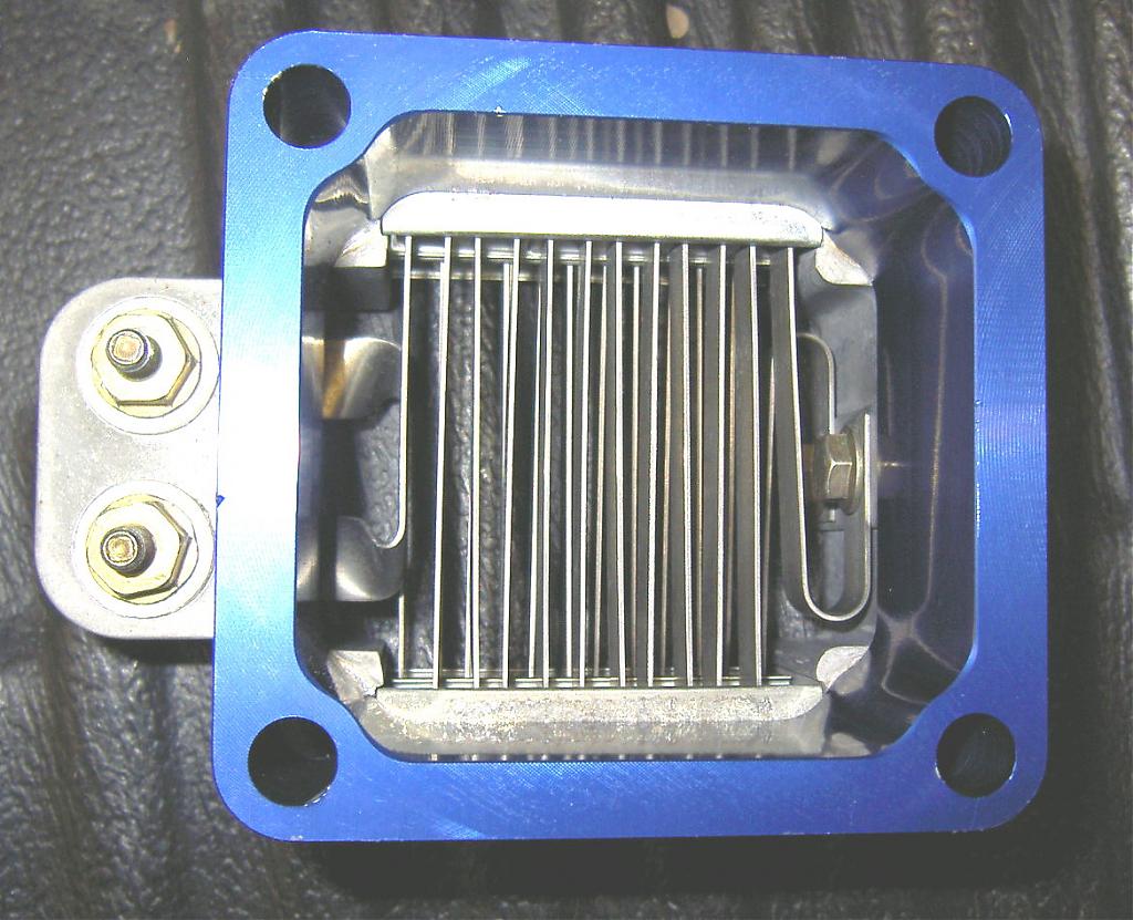

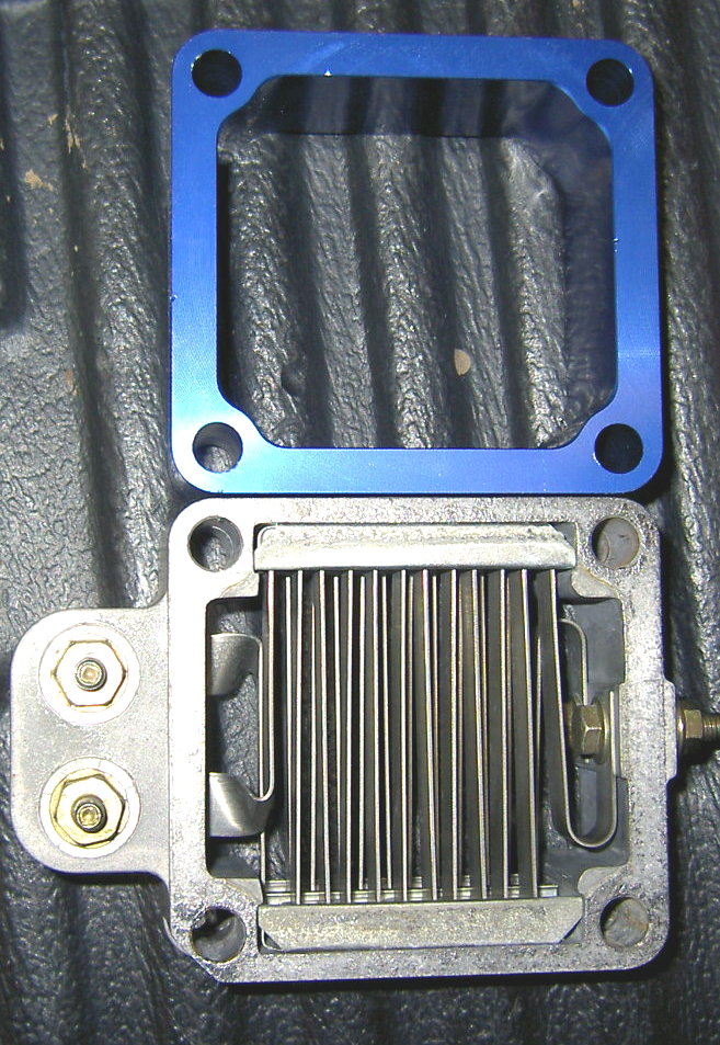

Here is a pic of the grid heater and a replacement.

Only when its below frezzzzeing. I know several persons who have removed the grid and never have a problem. Besides it takes about 10-15 mins to change....4 bolts. so you could run it in the winter if it gets cold enough and then take it out in the spring.
And 9 times out of ten the gaskets stay in place and are reuseable. Or buy the copper ones and never worry about it again.
